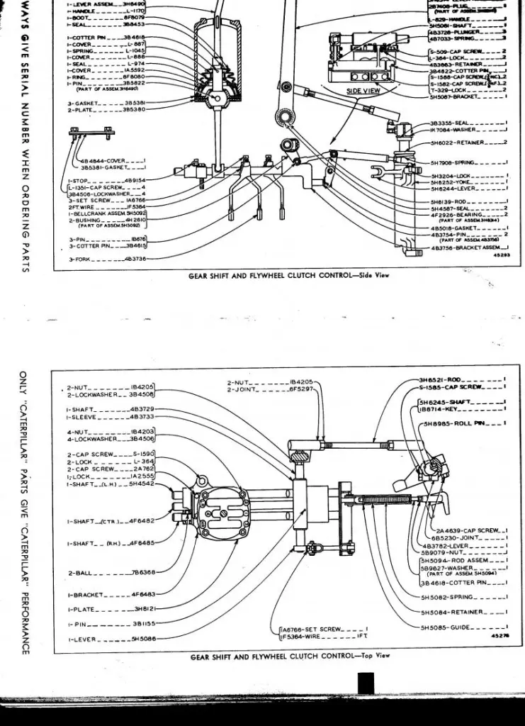

A 1953 933[attachment=55232]img013.jpg[/attachment]

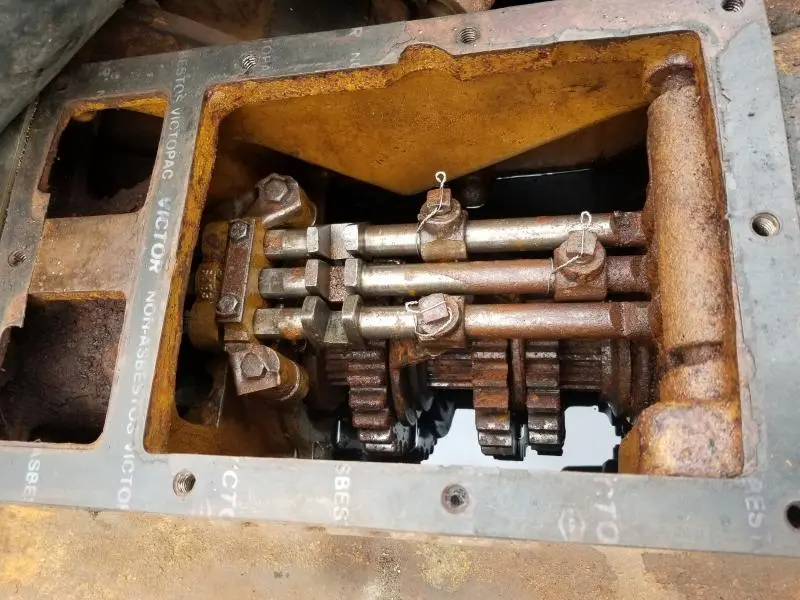

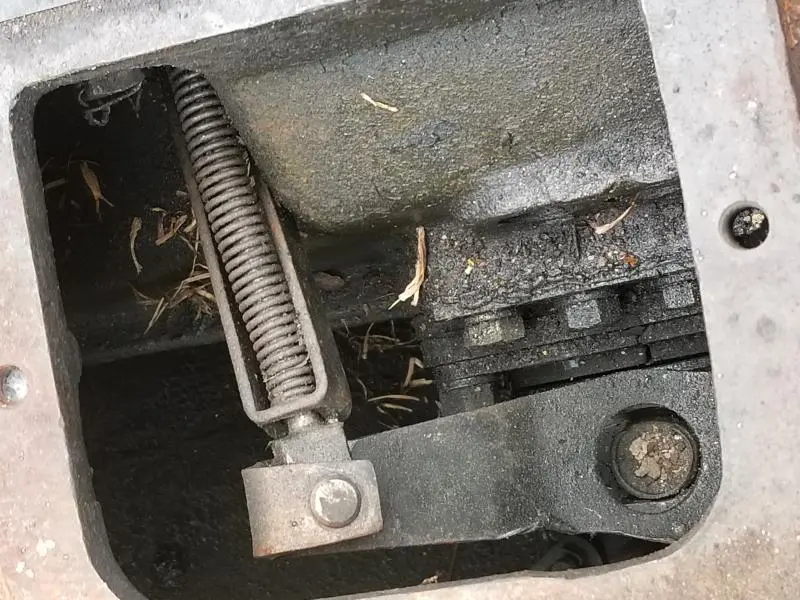

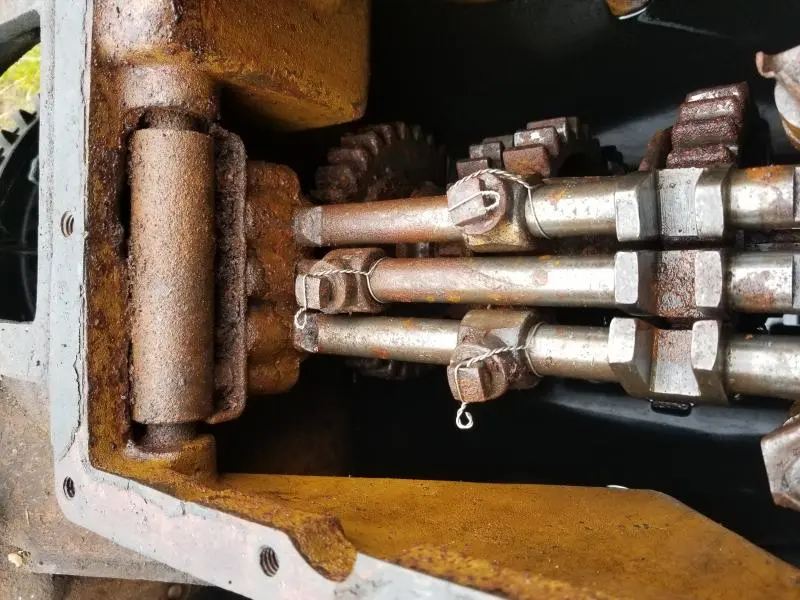

Here are some pics of inside the transmission, this one has the rusty shafts. See the view of with the spring, that is part of the detent linkage that must operate to allow the shift rails to both move when needed, and lock when the clutch is engaged.
If you have to remove the cover from the top of the transmission to break up some stuck parts, it's not very hard to do.
