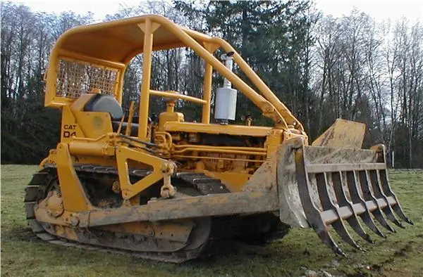

When I completely repainted my D4 7U about 8 years ago, I used Caterpillar Hiway Yellow which Cat charged me a little more for than what they charge for their modern Cat Yellow. It was money well spent as it is a very durable and the correct color paint for my Cat. 😉 My paint still looks great and where it is worn trough, the metal shines. Through my continued use, the worn through paint will never get rusty. I did plenty of prep like degreasing, sanding, and I used a replacement hood. In the attachment you can see my old dented hood. I did use a primer/sealer and I have not had any paint problems yet. It took from three to four coats of yellow paint for complete hiding. It seems like I used between five to six gallons over all. I had used a high pressure/low volume paint gun, but to save paint, the next time I will use my low pressure/high volume gun.
Your D4 looks great.
