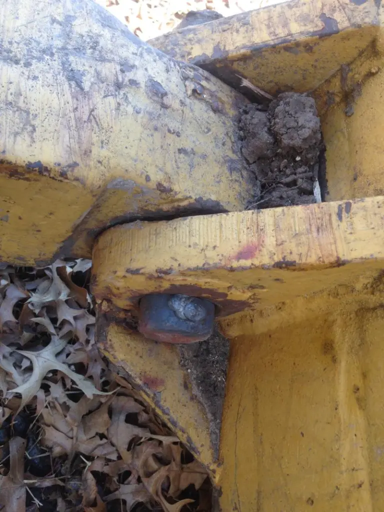

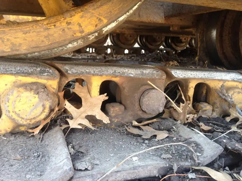

Good day guys, (inside anyway, rainy here). I noticed after a good bit of use with D7 3T a track pin had worked almost completely out. How fortunate for me to have had found after using a few hour and it to be parked. This pin (attached pic) was like inches out. Trying best to explain. These pins as you well know on tread plates have a outer and inner 'two piece female' connection. The pin had like wormed away completely from inside two piece female portion and was barely only still connecting plates with the outer connection. By using some bar clamps I was able to pull tread back in line and tap pin back into inner portion (much easier said than done). Even tapped completely in there is no protruding 'extra' pin at all on the inside. I know this probably isn't right. As pic shows it is different than every other pin on entire dozer. It looks like possibly an access pin? Also I had another pin issue up front on the left side of blade. This pin kept trying to work out. I finally melted a little dollup of welding rod onto (pic shown) and have had no further issue with it. Was wondering thoughts about acquiring longer tread pin and doing the same on tread. I can easily grind away rod to remove pins. Also I need manual. Seiscat, I have your advice to look for operation and maintenance instructions and service manual parts book. I read on archives that the service shop manual was the same thing cat sent to shops for them to use for repairs 'in the day'. Is this manual cover maintenance? Do I need 3 total books? [attachment=22005]009.jpg[/attachment][attachment=22004]008.jpg[/attachment] The id # 3T 20616..

You probably need a new master pin. The master lnks you're driving it through may be stretched a little, so even a new one may not stay put. If a new pin doesn't stay put, you may have to weld it into the links on at least one side. The master pin does not extend any farther outside of the rails than any other pin, but it is slightly smaller so it should go in and come back out a lot easier than a regular pin. If the master link is stretched, maybe a regular pin would fit tight enough to work for you.
One thing you may want to check is how far the track tension adjustment is extended. If it's at its limit, you may want to consider having the pins and bushings turned or maybe cutting a link out if the tracks are not worth the cost of the turn.
