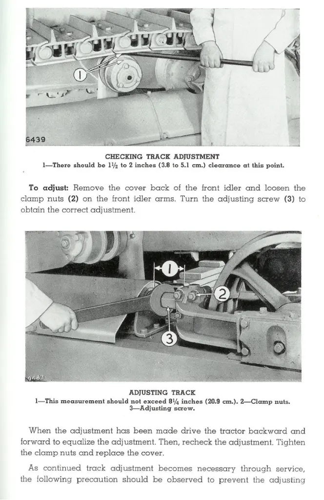

I have a machine that has 7 inches between idler clamp face and stationary plate face. was asking about how much space was there when the machine was new. thanks
Fri, Nov 3, 2023 1:41 AM
Posts: 16,780
Thank you received: 45
Reply to Catmanu:
Never seen a spec for new but here's the adjustment specs.
 [attachment=74201]D6 U Track Adjust.jpg[/attachment]
Fri, Nov 3, 2023 2:45 AM

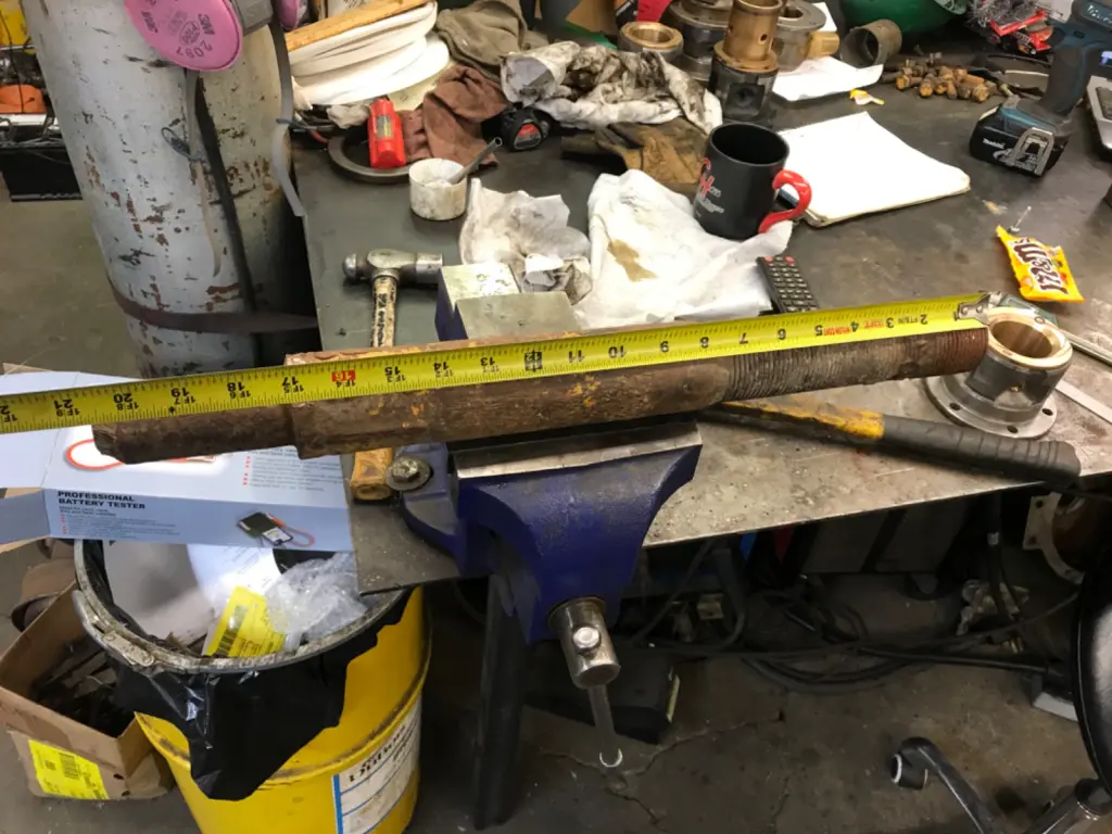

mog5858
Posts: 1,335
Well the one out of my 8u has 7.250 inch of thread. As you can see it’s needs a little help.  [attachment=74210]A7CF962A-F4E5-4AD5-ACC8-4AD78E24939B.jpeg[/attachment]
