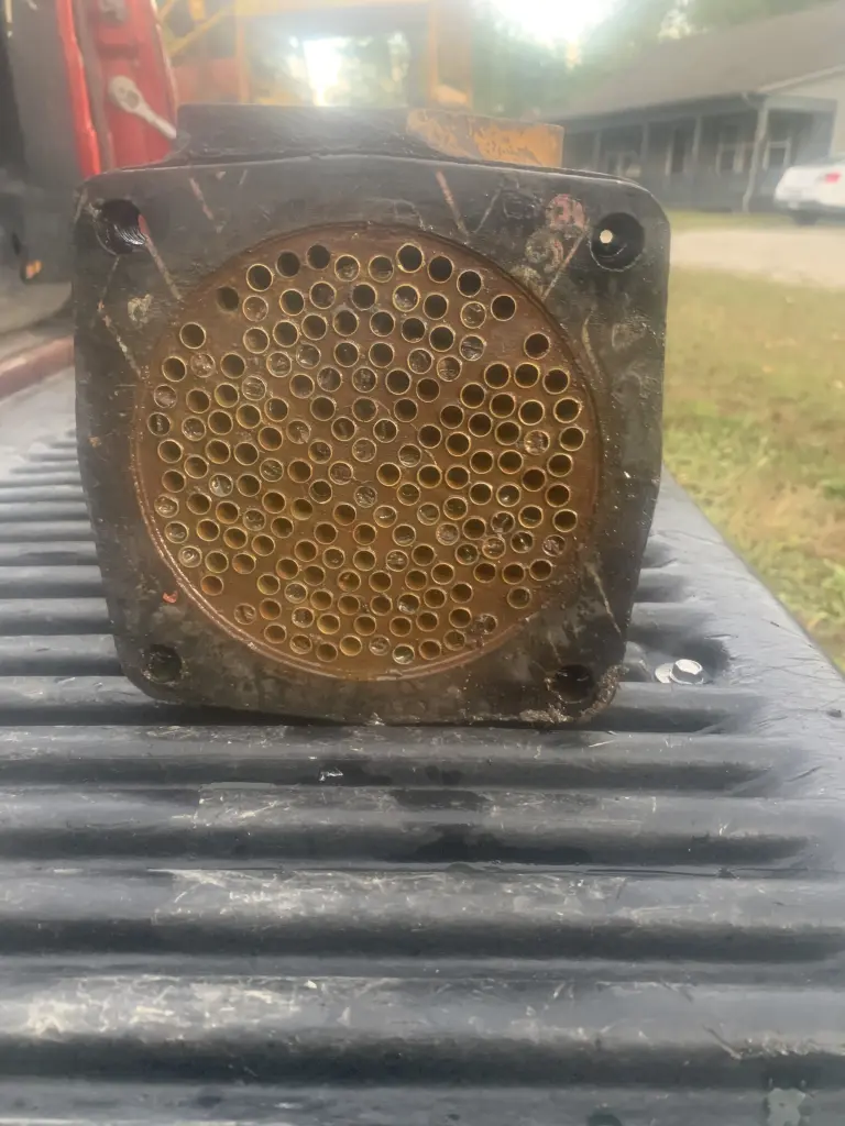

Hi well I installed a torque converter in a D9 19A and it got hot very quickly so took the torque converter cooler out and looks like this hopefully is the problem. I’m assuming it probably hasn’t been cleaned since 1957 lol and the oil cooler as well! I will flush the cooling system and clean pressure test the coolers before installing any other things I should do? Thank you Clayton

Looks nasty Clayton! Should be an easy fix though - fingers crossed!

yeah well theres your problem i would soak it in a cleaning solution rather than mechanical means. see if your local radiator service will hot tank it for you. or make your own hot tank.
a immersion heater in a pot of oil sitting in a bigger vat of cleaning solution

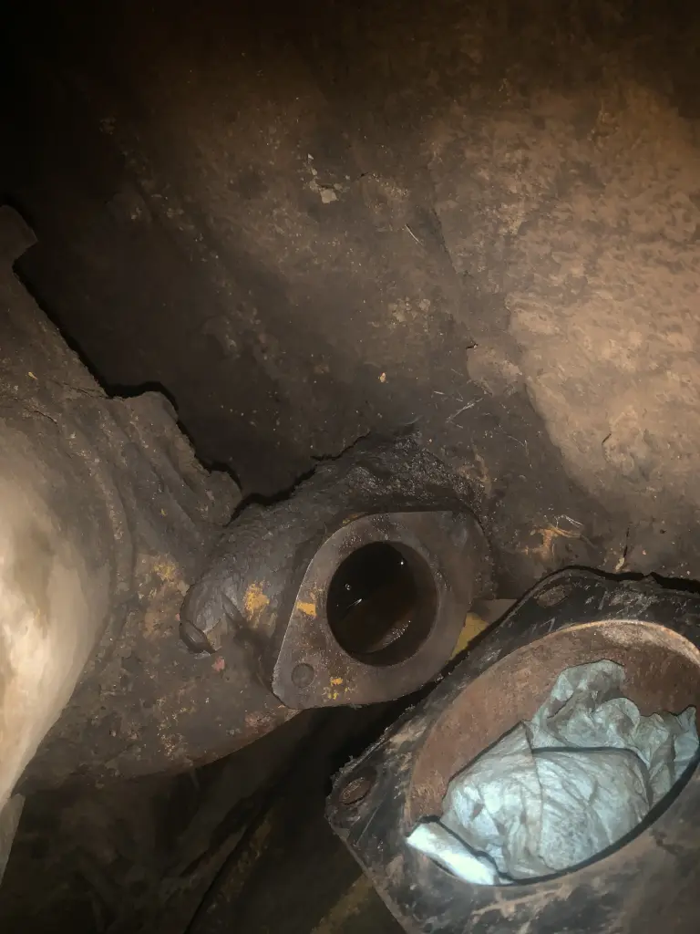

There is a troubleshooting section for the torque converter, for overheating in insufficient cooling it says to check the torque converter cooler for plugging which mine was about 85% plugged up! A question I do have is on the oil filter base where the oil cooler fits onto there are metal fittings that have rubber o-rings they are basically just pressed in the oil filter base but there is bolt holes on each side of the flanges which did Not have any bolts in them. Before I reassemble the oil and torque coolers I just want to verify that there isn’t a clamp or hold down missing. In my manual the oil filter base doesnt show any bolt holes on the base. I have attached pictures for a reference thank you Clayton.
