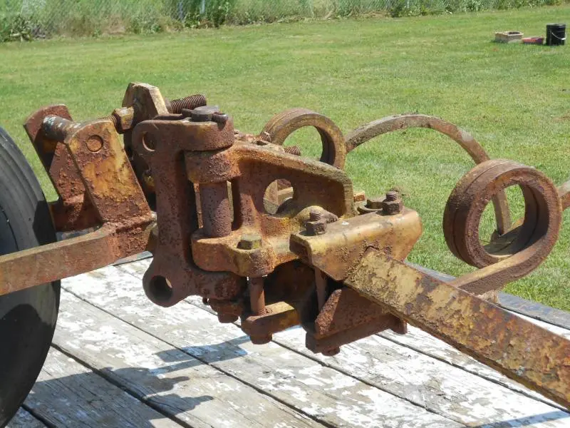

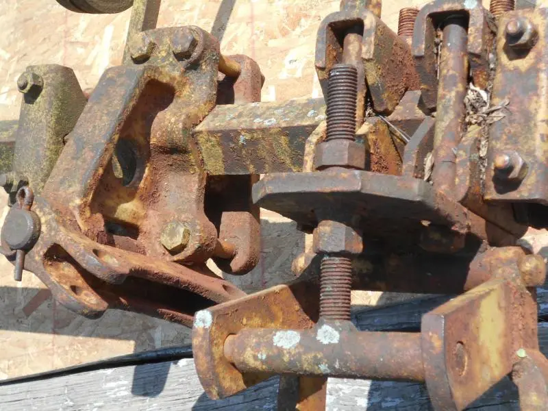

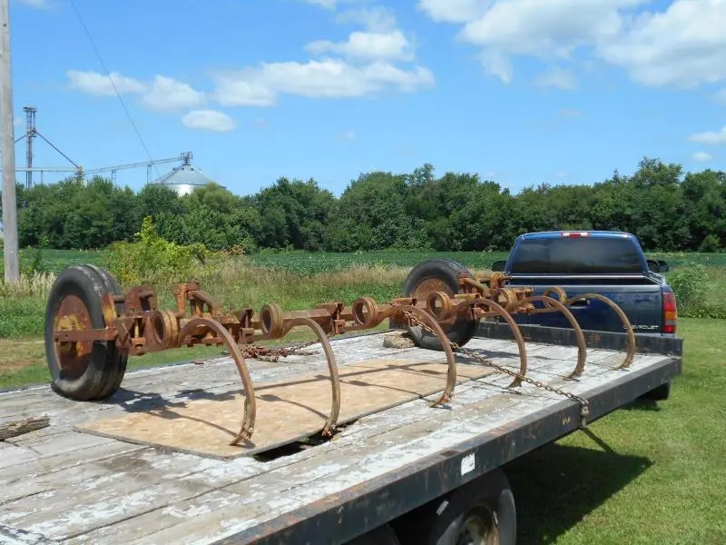

How much of this is cat?I know nothing about this thing.

Looks to be all Cat...

to me it looks all cat,, could use better pics of the gauge wheels though. is it available?
btw, its a toolbar but not a subsoiler, its a field cultivator set-up 4 a d2 or d4.

the pics u just posted indicate cat gauge wheels. the attach brackets r cat too. what size r the bolts clamping the t-b brackets to the beam? 3/4 or 7/8" ? nice find.

.750 Now that know its all cat I will blast and paint it.Thank you for the info.

That is a very nice find. I have been looking for one of those for the last couple of years and still looking. I would suspect that it would be rare to find one so complete even in the US.

do u have a toolbar tractor? make sure u run it in float. does it have chisel points (4 moisture invitation) or duckfeet points 4 weeding?

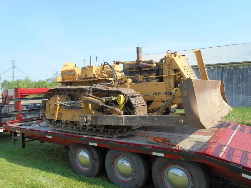

My plan is to remove toolbar from 7u parts-tractor,install on 7j,remove laplant system and install on 2t.
u'll have to drill the trackframes on that 7j, i also think u'll have to nut the back side, remove rollers??????? good luck.
