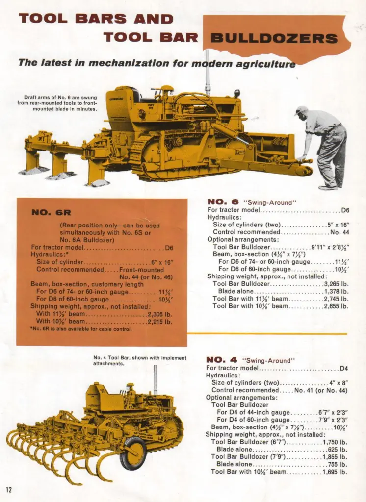

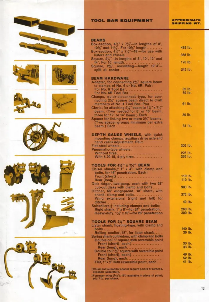

Does anyone know if the 8’x4 1/2”x 7 1/2” beam will work with a d47U toolbar bulldozer. I wasnt for sure if it was long enough or not.

OM so according to this a 8ft bar can be used on the swing around toolbar bulldozer of a d47U, but one would only be able to put attachments on inside of the clamp bars limiting the amount of attachments.

I have one of those shorter toolbars and I measured the width on my 7U and it looks like it should work but as you said you can only run attachments inside the draft arms.
