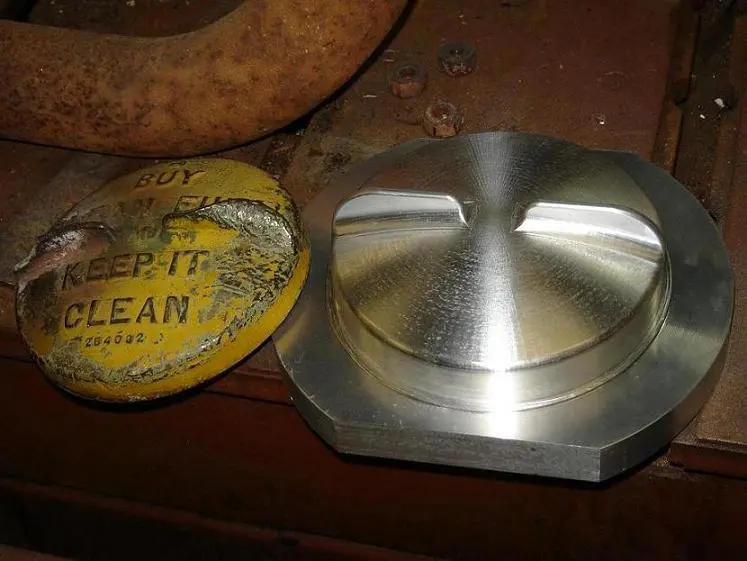

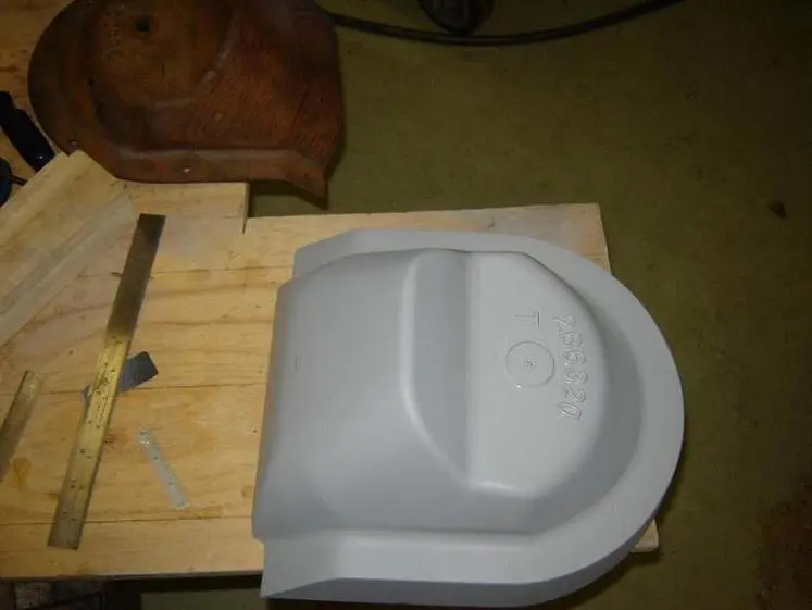

I just wanted to share a few of the projects that I am working on. One is a pattern for recasting the center piece for a 50 sprocket cover. I allready made the sheetmetal portion. I need four for myself, I could have more cast if anyone needs one. Also making a pattern for casting the brass gas cap to fit the 50 gas, may fit many others as well. Send an email if there is any interest.😊

Thanks for the nice comments guys, we are using Mastercam X2. I just did type up a more detailed reply, but I must have ham fisted it because 10 min typing just went blink & gone. 😕 Cap pattern drawn in solids, pathed in surfaces, last cutter was 1/4" ball mill. Gray pattern is wood build-up cut with traditional woodworking stuff. The letters were on 3wk back order so I engraved a mold and cast with Busmuth. More later
