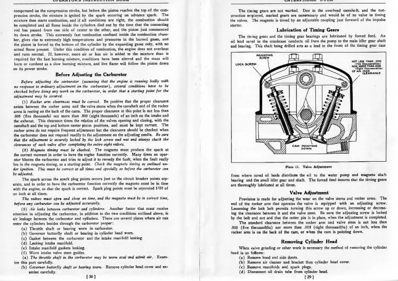

Hello Larry, I've got a two ton book that shows the gear train timing. I'll get a photo for you when I get in from the shop tonight.

To time the cam simply turn the engine to No's 1 &4 to Top Dead Centre (pistons up), rotate the cam until the rear cam is pointing straight upwards (No4 cyl. valves will be rocking and No1 valves fully closed with its cam facing straight down) and then fit the cylinder head.
