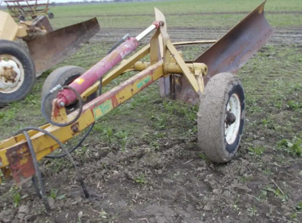

JM -- memories of days gone past! Smudge pots, return stack heaters (yes, they did keep the shop warm too), Burner Sleds, Floats, rotating spike tooth harrows, "drags" some of wood, some even faced with angle iron. Dad built a drag from heavy sheet piling that interlocked, it would flex as it rode over the dirt, a single sheet in front of a roller did a good job of smoothing the ground before harvest too. Your memories of our early farming practices, experiences long forgotten by many. Remember riding the "Vee Ditchers", that was always fun! - cts
When I speak of a Vee Ditcher, it rode on a long sled like arm that the cutting blade was attached too. Ours had a rolling colter on the front and the back had a wide "wing" that helped keep it straight against the forces of the blade. One rode the "Vee" to add weight to the blade and keep it engaged to ground. From the days of horse drawn equipment. I searched the internet briefly but found no pictures - 😪

Try this for the "vee ditcher" very similar to the one we had and used many times for ditches and drains in the orchard, flood irrigation days. Pulled it with the Ford 8N and later with the Ford NAA - cts --- https://www.youtube.com/watch?v=UpVKC1Zta4I

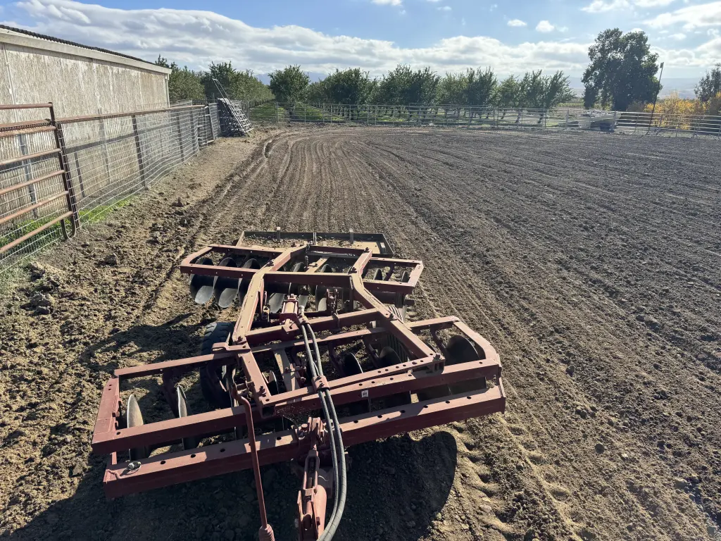

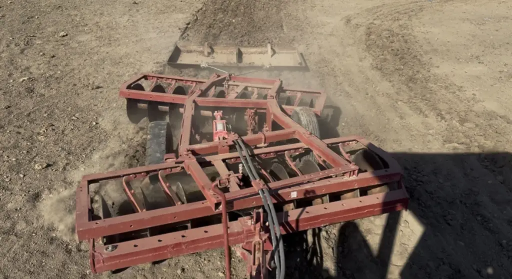

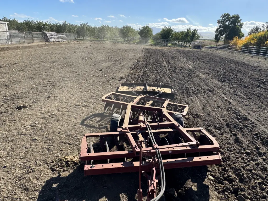

The disc is a 24B if I recall correctly. We had 2 in the junk pile one was taken apart when I was a kid, I recall going down to our local Helms tractor and parts were NLA and IH was no longer a company about that time. I actually threw this one in the dumpster and my brother pulled it out… kind of strange as it was usually the other way around. I needed a disc to disc my in-laws 1/2 acre of horse corral so I put this thing back together. Had to make a jig to plasma cut 3 1/2” hex or somewhere about that sized hex. The gangs had so much end play and I couldn’t get it apart I machined the ends and put some Marvin landplane wheel bearings with seals in there.
Originally the disc was primarily used when closing up vee ditches pulled behind a D6 9U to D5B or modes in between to dry things out. Occasionally used behind a wheel tractor in the spring for all of the odd shaped parcels for weed control.

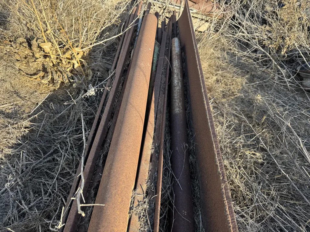

The drag was always along the row of equipment in my lifetime it’s actually called a soil surgeon. I guess my grandfather like using it in the 50’s, my dad never had anything nice to say about it whenever I asked. Something else that was moments from scrap after my grandfather passed that I brought over to smooth things up for my daughter. Apparently they pulled it behind the high crop 420 JD or Farmall 300V when cultivating tomatoes to firm up the beds. When mechanical harvesting and direct seeding become popular they had a Marvin or Johnson pre plant and lay by power mulcher/ “Marvin Row Master” / Johnson Incorporator that would till and bed shape in one pass. About that time they probably got some small Schmiser ring rollers that I always recall pulling behind the 3020 High Crop. Those two mechanical purchases made this obsolete probably late 60’s.
There was another set of those soil surgeon that had a piano hinge in the middle for shaping Alfalfa borders, but I don’t know what happened to it as it’s been at least 40 years since I recall it being on the ranch. I had a stack of concrete pavers and some cast tractor weights for this for weight but not sure where my mid 80 year old FIL did with them.
We had a wagon for burning in the orchard, slotted angle iron floor, steel plate sides, steel wheels front and back. I only saw it being used for burning other stuff, cut up by tweakers about 2009.
we just had suitcase weights on our atlas vee ditcher, but you could hitch a ride on the back.

I had an Atlas Vee ditcher almost identical to yours. It was too lightweight. It sat in our boneyard for decades. Finally one day I took an empty tomato paste drum, tack welded it to the crossbar in back; tossed hundreds of pounds of used cable/strap winches from trailer projects. What a difference that made. No sooner than I did that, some guy came along and offered me $1500.00 SOLD!

cts what you describe as a vee ditcher would possibly also be called a delver. drawn behind the tractor to cut irrigation ditches and to keep them formed up. the style ive heard of had two adjustable blades so you could set depth/width of cut the soil would roll up the blade and be deposited on the banks of the ditch as you drove along. the uncle worked in the queensland cotton industry. a number of cotton growers would also grow a grain crop in between cotton season.
