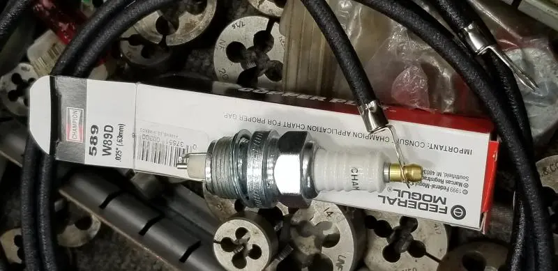

I found some plugs at NAPA and a set of wires at Brillman. Hope to have an engine assembled soon for trials[attachment=53805]20190509_221227.jpg[/attachment]

I was going to ask what is the difference between a Champion 589 and a D16 or D21? (Heat Range wise)
I see it is an extended tip plug allowing the gap to actually be down inside the combustion chamber.
Reasonably certain I am on the right page in my mind as a 3076/3077 are D16/D21 equivalent?
Is my observation correct? :confused2:

No idea, I liked the long insulator and didn't do much cross checking, too much other stuff to do right now, was ready to get it over with. I think it will be ok
