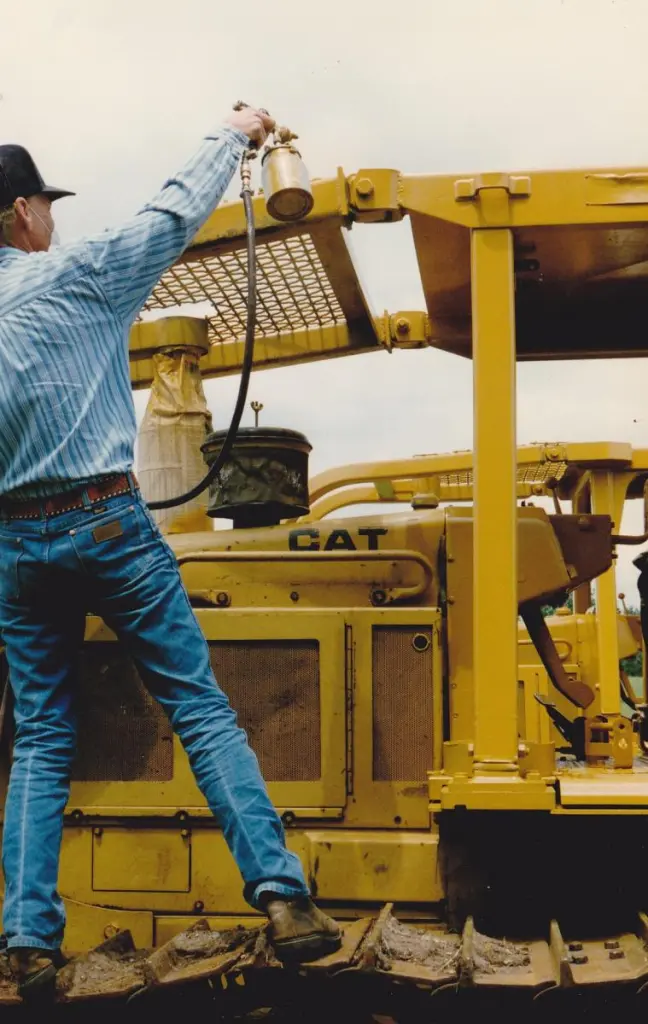

Photo 5: We don’t need no stinkin’ paint booths!
[attachment=42062]CE 1.jpg[/attachment] [attachment=42063]CE 2.jpg[/attachment] [attachment=42064]CE 3.jpg[/attachment] [attachment=42065]CE 4.jpg[/attachment]
[attachment=42066]CE 5.jpg[/attachment]
