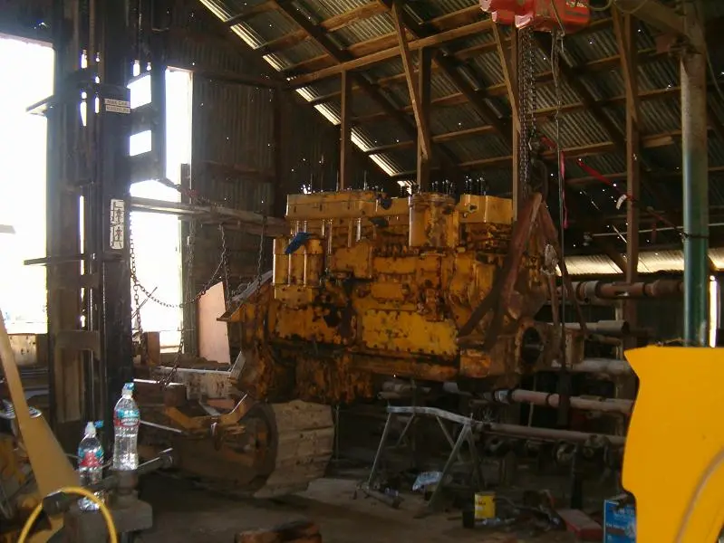

Hey Joe, I've pulled two - 2U engines lately 😄 . Unfortunate you have to pull it to work on the oil clutch. The engine isn't that hard to pull if you have a forklift or crane, it's heavy 6K. Just keep track of how the shims are stacked. That way when you go back together the U-joints will be lined up.
My crane or forklift would pic the whole engine up so I had to use both. Which ended up working really well because I could adjust the angle.
