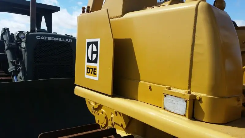

A military D7F should have a 61G SN, not a 94N. It looks like somebody might be trying to pass this unit off as a low hour cream puff.
Does it have a carbine butt holder mounted on the floor plate to the right of the seat and sorta in front of the decelerator? That's another giveaway.
On edit, I'm looking at the OD green dozer in your picture and thinking that's the D7F in question. Maybe you're talking about another one.

Thanks for the info Old Magnet, d9gdon and D6c10K. Yes, the D7E(yellow tractor in the photo) is equiped with both back-up ripper mounts and a towing winch. The undercarriage has Cat alligator master links and is sealed but not lubricated. This machine was priced $28,600. There were several things that I did not like upon my inspection even though the appearance was good.
The D7F(o.d. green tractor in the background) does not have back-up rippers nor a winch. The information plate on the left side of the hard-nose stated the serial number of the tractor, the serial number of the engine, and the year of manufacture(1973) and stated Department of the Navy. The patina etc. of the plate lead me to believe it is authenic. I think the tractor was for the Marine Corps as the Navy was notoriously stingy with them. The Seabees generally got what they wanted.
Any thoughts?
