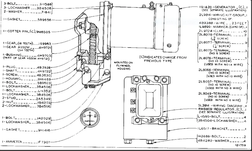

a 12v generator you wouldnt know the part no: would you Neil as my book only shows 6volt systems. that could be the solution. machining gets expensive fast.

If you want to go to 12V you could chase up a 1S1420 generator it is a 12V generator, I do not know what they where on, but I do know it uses a delco reg

1S1420 is a Delco 12v gear drive generator used on the big engines, D342, D343, D353, D8H, D9G and a few others.
There is a lot more flexibility and parts available for the Delco Type A generator than the Type B American Bosch.

one question is that drive gear the same or atleast the same pitch things become more "fun" if not. the gear shown for my machine 4f6981

Not the same gear train as the 6U/7U....

[attachment=62749]1S1420.JPG[/attachment]![]()
hopefully the shaft size is the same as the original allthough thats not hard to get around gears can be bored and keyways recut.

The shaft is the same size as the others as I have one on my R4 which I run a 26 tooth gear.
