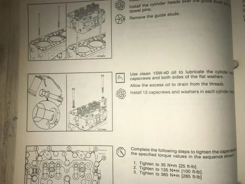

My Cummins manual shows to lubricate all the critical bolts and both sides of the washers.
I’ll look tomorrow and see the torque difference between lubed and dry same size bolts.
