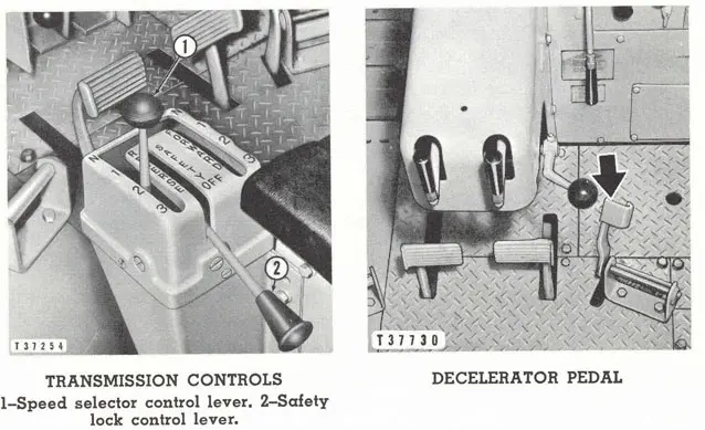

I can't find any comments here, but shouldn't the "SAFETY" lever on the D9E model powershift console be painted RED?
Even the (included) scaled down spec sheet, though in black & white, shows the lever in a gray shade, as opposed to the shift selector which is solid black.
Second comment-
is the throttle lever STRAIGHT on the D9E? On the D9G it is angled toward the operator about 10" up the hsaft.

It looks like you are right on both counts for the D9E. The majority of the images look like they show the safety lever a different color, although in the OM&M, which I relied heavily upon for the model, it looks the same color as the gear lever. The governor control lever should be bent. In looking back at the D9D literature, even some of the images for it show it bent. We mistakenly carried it over as-is from the D9D. I've contacted First Gear to try to get both changed for the D9E hydraulic blade version. Glad to hear that you like the model despite these flaws.

The knob should be red - I've painted mine.
