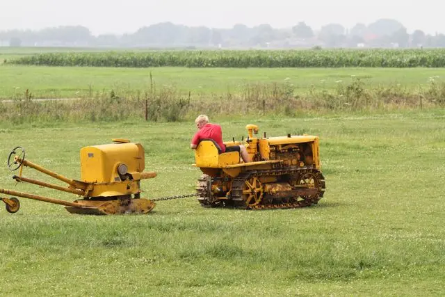

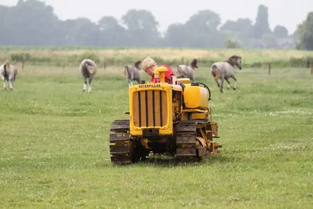

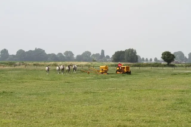

After the rebuild last year.
Today was time to test it out the first time.
Behind it is a vibromax atn 5000 About 2,5 ton
It has a 1 cilinder deuts evaporation engine
So it is an open system
Last thing to do is finish the hydraulics.
I'm now waiting for the hoses and tank.

Tell us a little more about the compaction contraption, approx. year, how it works etc. Must have been a pioneer in vibratory compaction machines. Tractor looking good.

You certainly got the horses attention. One horse to the other- "Wow! What is that making my legs vibrate?" "It's making my tail twitch!"
Jan
PS- Be most careful running that compactor next to dike!

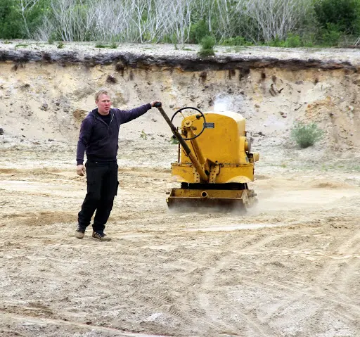

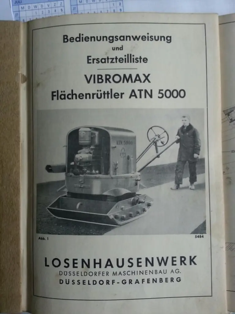

[attachment=24272]vibromax.jpg[/attachment]
In the link you see starting the fibromax: http://youtu.be/ak8LJaFJPkg
It was in my granddads barn for about 30 years.
We didn't know to start, but found the can with start fuses it was a little easier (you see i burn my hands on it:loco😊

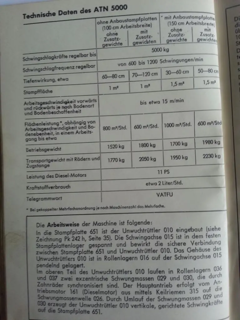

It is a deutz MAH 14 with 11 HP. This is a engine with a open cooling system so you put water in it.
That's boiling the water is turning to steem and the engine cooling.
when you use it you have to put water in it every 15 or 20 minutes.
it compacts the ground 60 till 120(!) cm with a range from 1.m2
And you do 600 till 800 M2 per hour.
1770 KG 2300 kg in transport.
2 Liter diesel pro hour
1962 it was build, the first one was build back in 1937(!)
build by Losenhausenwerk Dusseldorf Germany.
for the transport they put it behind a little truck.
My granddad buyd it new for big road work.
In the first it was 2 times under the sand... why? because the dutch ground is so soft and wet
It was to strong so it was going down, they pull it out with a dregline.
so as jan said don't come to close to the dikes 😛

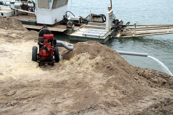

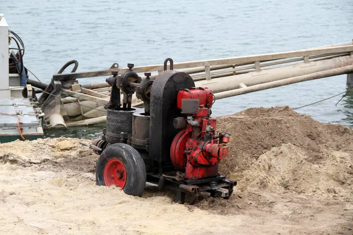

after a few your they park it in the barn till 2012 we had to clean all the barns and we found it.
With The d2 5u dozer and e few waterpumps. We sent about 200 ton iron to china.
*[attachment=24270]pomp.jpg[/attachment][attachment=24271]pomp 1.jpg[/attachment]

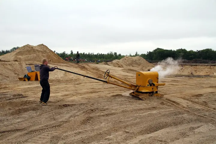

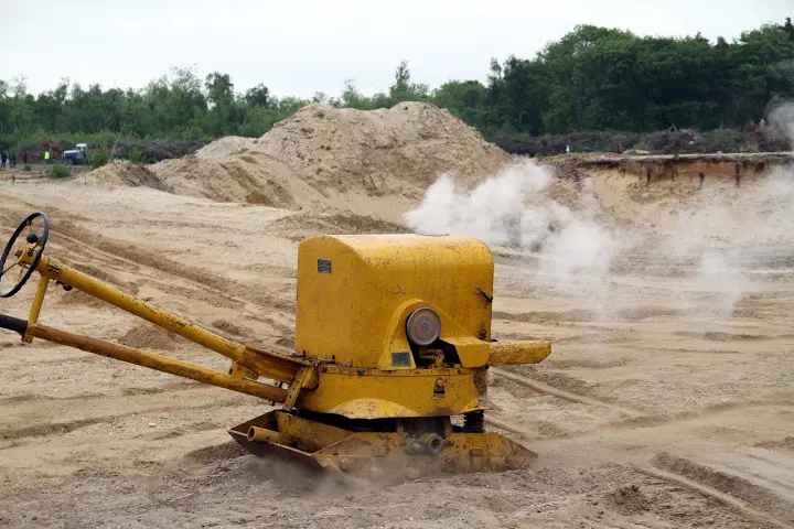

We get it out and try to start but it won't fire up only a lot smoke.
than put the start fuses in it en 2 spins an it was going on 30 year old diesel without any problem!
Pulled the coupling to activate the compactor and my mom was coming out wtf are you doing my kitchen is walking away!
Starting it on the street wsn't the best idee :noidea:

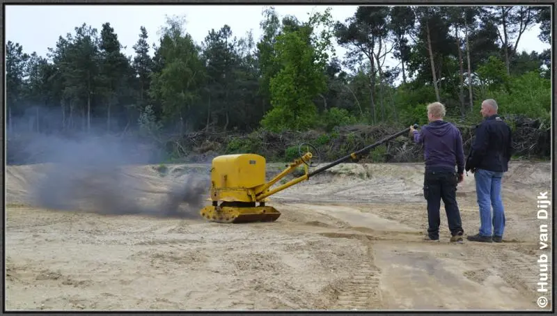

[attachment=24274]vibromax 2.jpg[/attachment]
[attachment=24275]vibromax 3.jpg[/attachment]
her it is so smoking because this was the first time real working after it it was only the steam came out

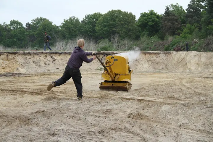

[attachment=24276]vibrombax 5.jpg[/attachment]
[attachment=24273]vibromax 1.jpg[/attachment]
It is hard working to get it turned! for reversing it you have to turn the weel so fast you can.

Did they use this in the usa back than?
I don't think these machines were shipped out of europe.

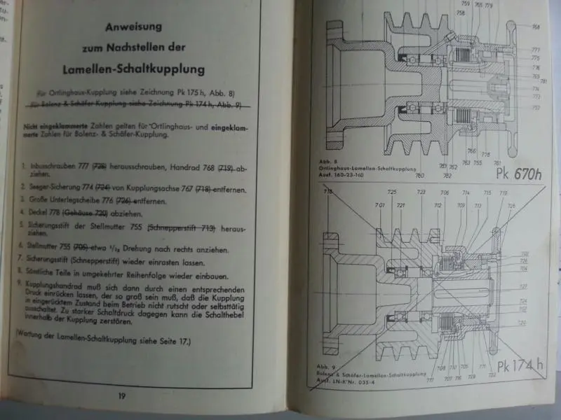

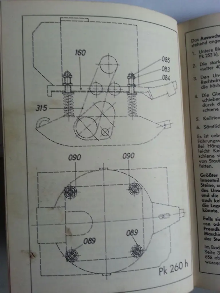

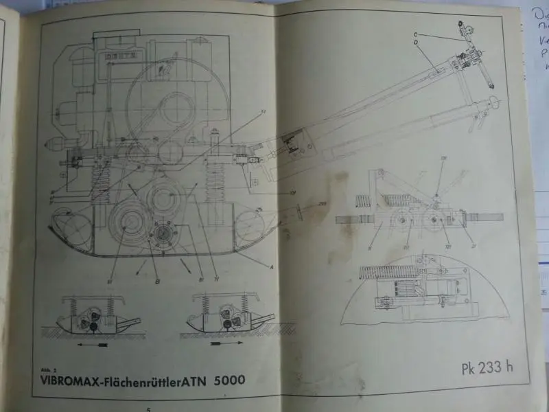

Does the belt drive an eccentric weight?

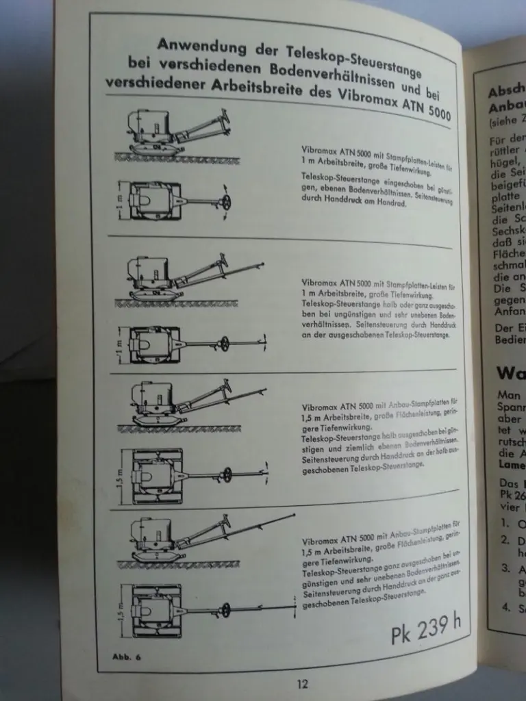

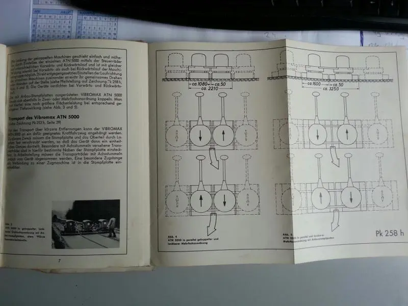

Yes!
See the photo's
You see they also build a tendem with 4 together!!

Ahead of it's time, it is the same design as modern compactors, they have just been refined. Thanks for sharing.

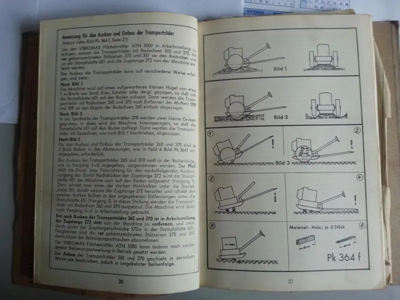

i add the technical sheets so take a look and improve your German😛
Indeed it was ahead of it's time!
