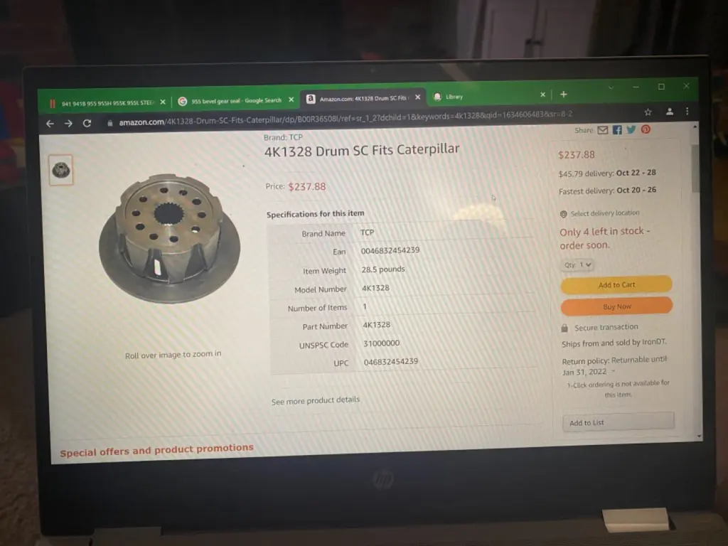

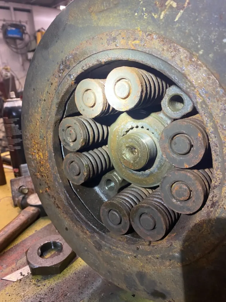

Well I finally got around to getting the 955 12a shaft for my D4 7U stripped and found one of the clutch drums are cracked. Waiting to hear back from the salvage yard to see if he will replace it or not.
If he is unable to replace it for me I found one on Amazon. Is the TCP brand ok? Thanks.  [attachment=65080]D1DD72AB-068E-4253-8DE7-0701C4C7E7B3.jpeg[/attachment][attachment=65081]3572EF07-1EC0-4A79-9E9E-8898BE1DF815.jpeg[/attachment]

I just got around to reading this post. The picture of original hub and the picture of the TCP hub DON'T match!
Follow Rome/KG'S advise and find the correct hub.
