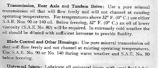

    Hi Team,
    scan from my grey No 12 7T Operation & Maintenance Instruction Book.
    I stand to be corrected---- but it is likely that one of the modern thinner Universal Tractor Transmission/hydraulic oils would work in the colder climates as well as more temperate ones--others from the Northern States would be better guides than I.
    Hope this helps.

    I agree with Eddie. This winter, I would drain the transmission and refill with a tractor hy-tran fluid to run until hot weather and to act as a cheaper flushing fluid. Then assuming you get it shifting properly, you may want to refill with a 50 weight gear lube as specified for many modern heavy truck transmissions these days.
    Sorry I cannot help you on the plugs to drain and check level etc. Had a '53 212 for a few years but too long ago to remember how it was checked and filled. I would bet it holds more than 5 gallons though! I am thinking the transmission lube will likely equalize with the rear end housing so you may drain both at the same time??????
