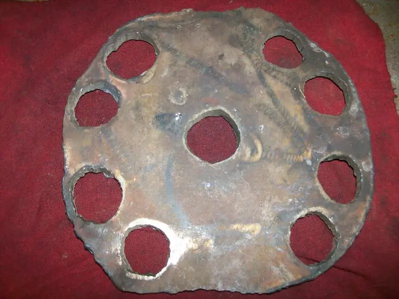

I made my own for a D6 out of 1/4 inch plate. It compressed them all at one time it never dawned on me you could do 2 at a time so did them all at once. Will see if i have pic.
