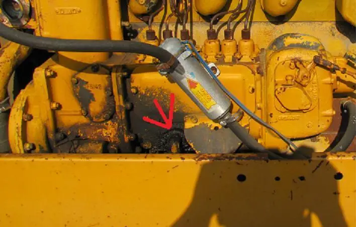

Ok, I've started getting my grader ready to start, can anyone tell me what size socket I need for the large inverted hex oil drain plugs on the diesel engine and transaxle?
Also My operators manual shows a filler "spout" on the injector pump, but mine has some sort of drain that points down and then connects to the crankcase, I thought I read something about newer engines being fed oil from the engine oil pump and then draining back into the crankcase effectively eliminating the need to check/change the injector pump oil, is that what I have here?
Here's a picture of my injection pump:[attachment=6368]pump drain.jpg[/attachment]

There are, to the best of my knowledge, 2 sizes of those in-hex wrenches on Cat machines. One is the same size as a 5/8" SAE bolt head and the other is the same size as a 3/4" SAE bolt head. The 3/4" version is the more common. You can make a wrench to do this job by welding a good solid handle on a 3/4" by about 2" bolt. Make it solid. These plugs sometimes get rather tight if left unmoved for a while.

Never saw an injection pump housing arrangement like that! Looks like they just have a small amount of oil flowing into it and let it spill over to control the level.
The other good way to make a plug wrench is take a 3/4" bolt at least a few inches long, screw a nut on it and weld it on tight. Then you can use a 1 1/8" socket on one end and stick the other into the plug. This takes up less room in the tool box and allows you to use whatever kind of "handle" you want.
Thanks for the reply's, I'm going to try and make myself a tool out of a bolt and nut I just hope I have a large enough bolt laying around.
I'll try and get a better picture of the injection pump today, anyone else seen this setup before?
