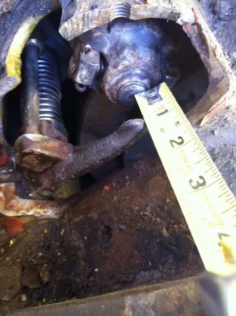

How much space should there be between (sleeve) that the latches are in and the arm that pushes on the sleeve?There is an inch of space on this one while it sits. when lever is activated arm moves foward pushing sleeve foward but does not latch,return spring totaly compressed.I put a temporary spacer between sleeve and arm,allowing the sleeve to be pushed further but still don't latch I can see the latch springs are working.Thinking of removing the the unit which means lifting the pony, do I have remove the govenor to get enough room also? If so is that very detailed?This is on a D4 Serial #7J1905W
Thanks,quinq

[attachment=20119]strater pinion.JPG[/attachment] Here is a pic. It came with the custom accsess hole:jaw:

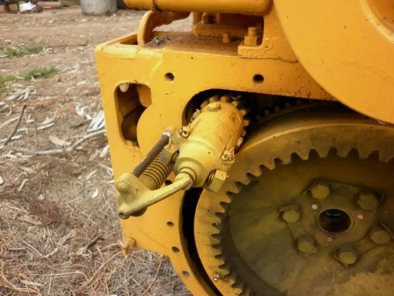

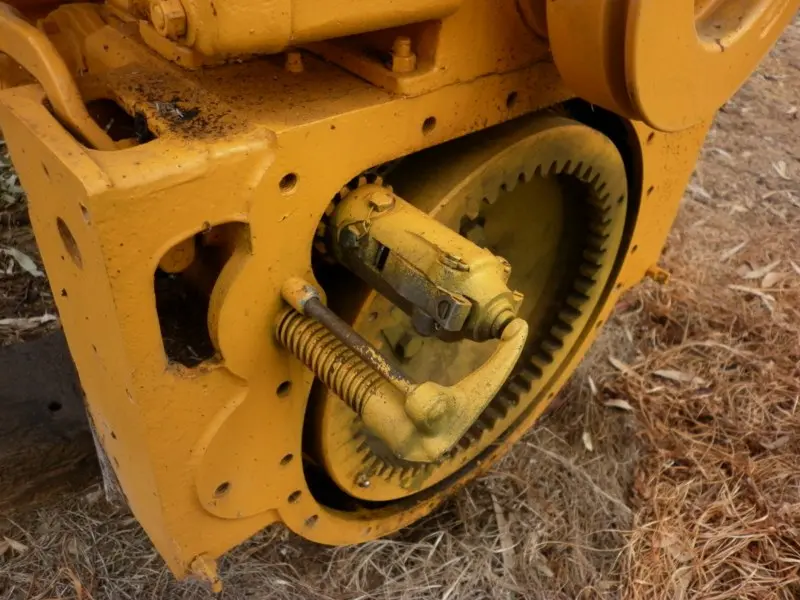

This will help hopefully, if your 2 latches are worn they will not lock, just be aware if you want to buy genuine replacements from your local Cat Dealer take a bottle of smelling salts with you when you go to pay the bill, they will need the salts to bring you round again after you have fainted, they are about $100 each!😆

Thanks for the replies,I see Mike's pics show very little space vs 1" on mine.does that mean that the return springs are broke?I might try adjustment of latches.I was quoted 186.42 ea for the latches.Could the latches be set so tight that they can't ramp up on the lock? Can the gov. be removed fairly easy for clearance for removal of unit?
Thanks again,quinq

WOW, "Only" $186 each for those latches, I thought the $100 I got quoted a year or two ago was bad enough!😖mokin: Is that large spring broken in the middle, or is it just the photo? Before I started pulling anything off I'd be squirting a 50:50 mixture of diesel and ATF over that pinion for a day or two and working it back and forwards, it is not unknown for them to seize up, and looking at your butchered housing I suspect you have had plenty of dirt floating around there.
Try the easy fixes first, before abusing the check book and your fingers.

Probably nothing wrong with the latches. The engagement arm is bent to where the latches will not engage. Most likely due to wrong speed release adjustment or sleeve is loose from pinion. The price you pay for manually holding in the pinion without latch engagement.
