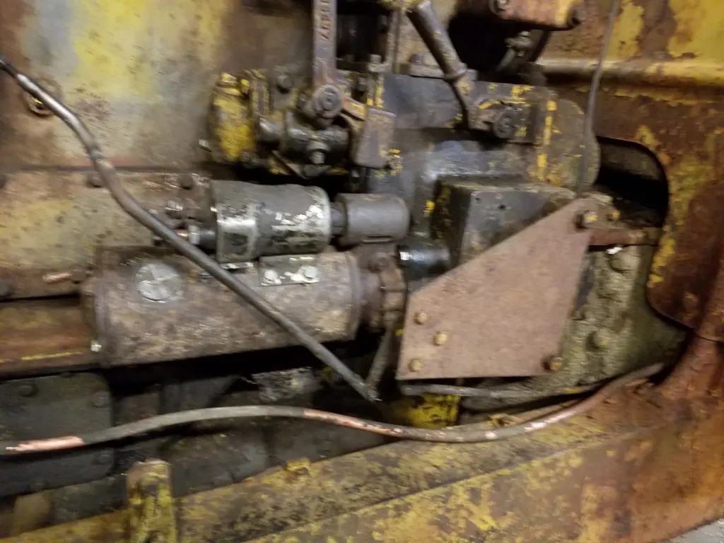

Thanks for the dimensions and info. Seems it comes out very close to that of the 8T grader with D318 using 10.3125" down from the pony mounting flange and 3.4825" in from the flywheel housing edge. Do you think the 3.4825" would have worked in place of your 3.255" dimension?
I think the 3.4825" would put the starter drive in too far. At 3.255" the teeth in the starter drive are almost bottomed out into the flywheel. The Drive End Housing sets perfectly on the raised boss on the flywheel housing. That extra .2275", I think would be too tight. Maybe the clutch housing for the 8T Grader with the D318 is a little wider than the one used for the 4600. The part number for the Clutch housing for the 4600 motor for the 9K and 7T grader is 8B2680, where as the Clutch Housing for the 8T and D318 is 2F6112, which leads me to believe the housings are different. Brian Boaz

I'm curious to know what kind of an arrangement you used to mount batteries for your direct start. Not many options available.
Did you bore 3-5/8" or 3-3/4" for the starter nose?

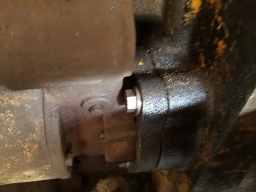

When you re-clocked the drive housing what was your method to handle the near covered access to the one 5/8 mounting bolt. I have been using a 5/8 button head cap screw which just clears a 3/8 long reach ball end allen wrench.
