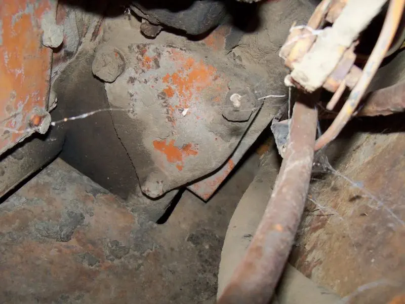

The conversion will be easy if there is a bore with a cover on it below the existing pinion.
This cover has 3 bolts/studs and nuts holding it on. Otherwise the flywheel housing may just have a raised portion that will need to be machined. This machining must be done to VERY close tollerances. I think there is a pic of this area on the King of Obsolete's post about the D6 he is working on. Look at flywheel housing strapped to a skid, hannging on a crain.

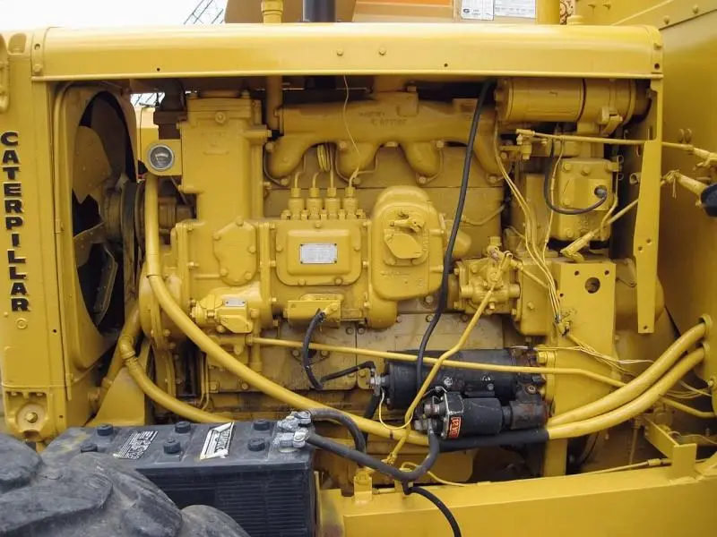

These photos might be of some interest...Found these photos of a CAT112 Electric Start Conversion...The back view is just showing how the battery mounted to the frame...The side view is good for the starter mount...I've got a CAT112 that I just may try this on...It has the factory machined hole in the bell housing for an electric starter...

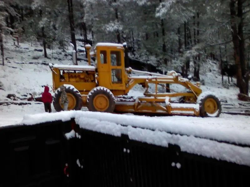

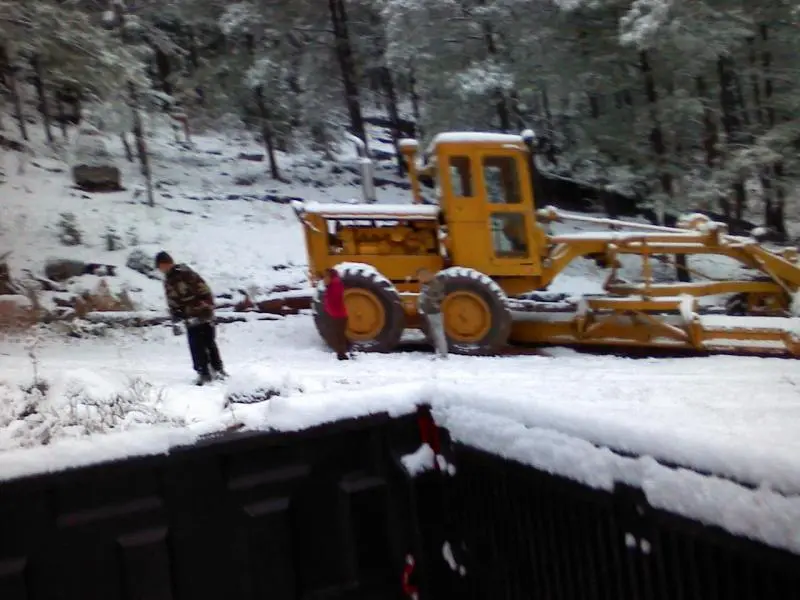

This is a 1950 year #12 8T grader. catskinner
