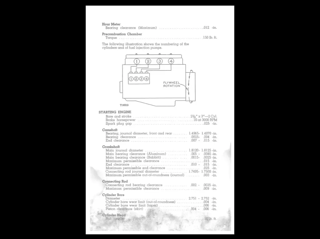

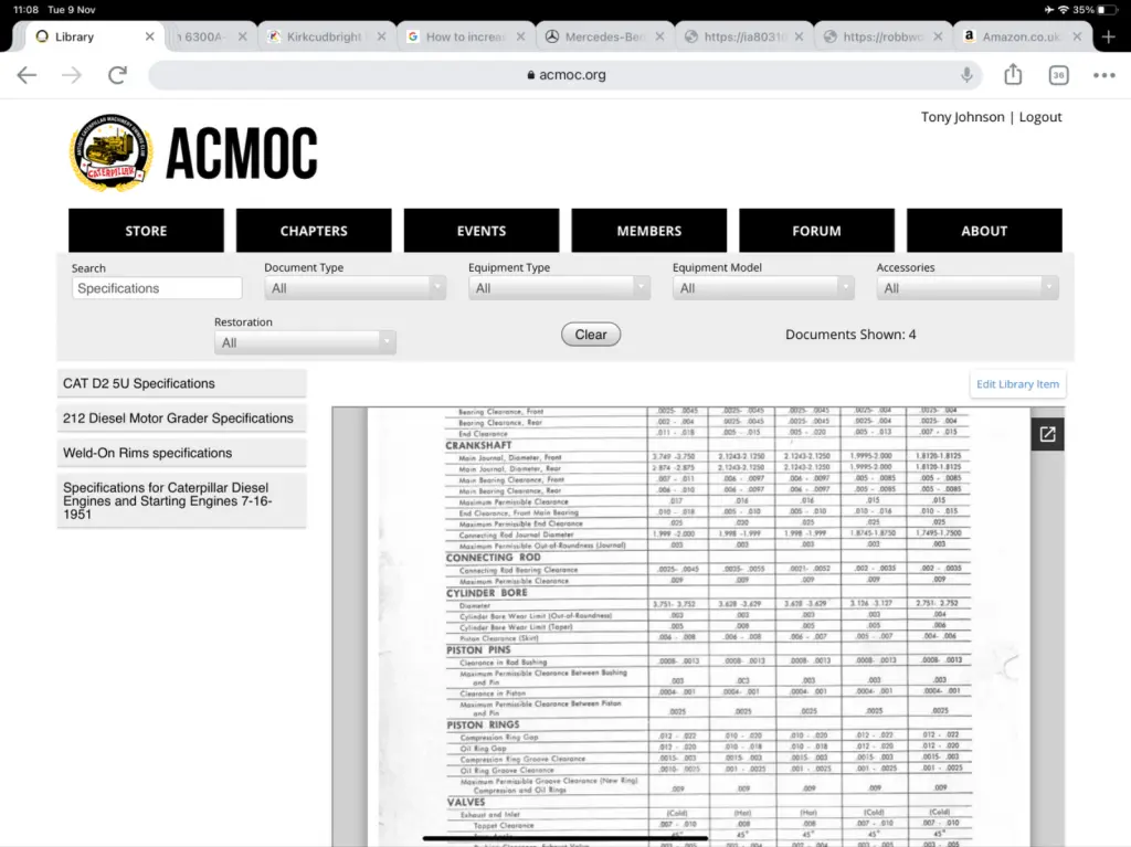

Interestingly it doesn’t list the piston size in the Specifications manual or the 3400 servicemen’s reference book. Just the bore allowances and the out of round.
 [attachment=65278]76A6A6AC-3025-4B06-AC19-AEBBD8A42A04.png[/attachment]
  [attachment=65279]5fca18db620d6db5454ee44cc0261207[/attachment]
At least I couldn’t see them. Guess they figure it can be worked out from those figures. I’ll look at the other manuals as the D4 shares the same type of starting engine.

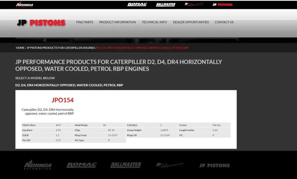

Attached is the spec sheet from JP pistons that makes a replacement piston for the D2 pony motor. [attachment=65282]Piston.JPG[/attachment]

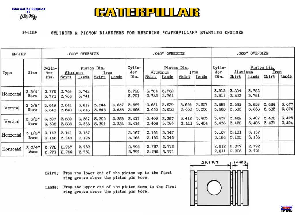

Hi Team,
pony piston specs.
Wed, Nov 10, 2021 10:55 AM
Posts: 7,211
Thank you received: 57
Reply to edb:
Hi Team,
pony piston specs.
