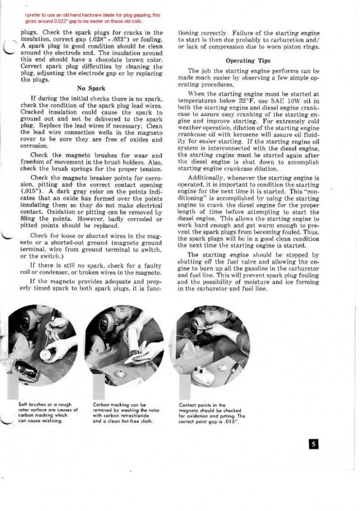

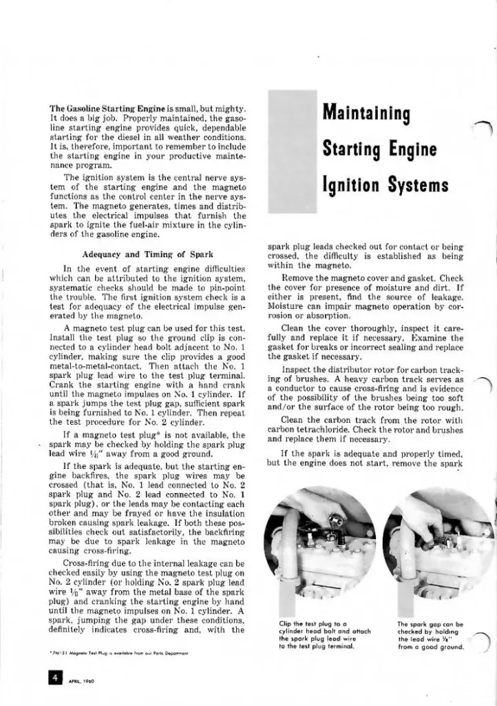

Hi Team,
have found some good info from an old Service Reporter April 1960.
Hope it helps someone out.
Note my prefered plug gap of around 0.022" for use with our old depleted insulation quality magneto coils.
Get these while they are up. They may be suitable for the Service Library.

Reply to edb:
Hi Team,
Thanks edlb,very helpful. I guess I will have to break down a purchase a service manual. $ starts to add up in a hurry.
