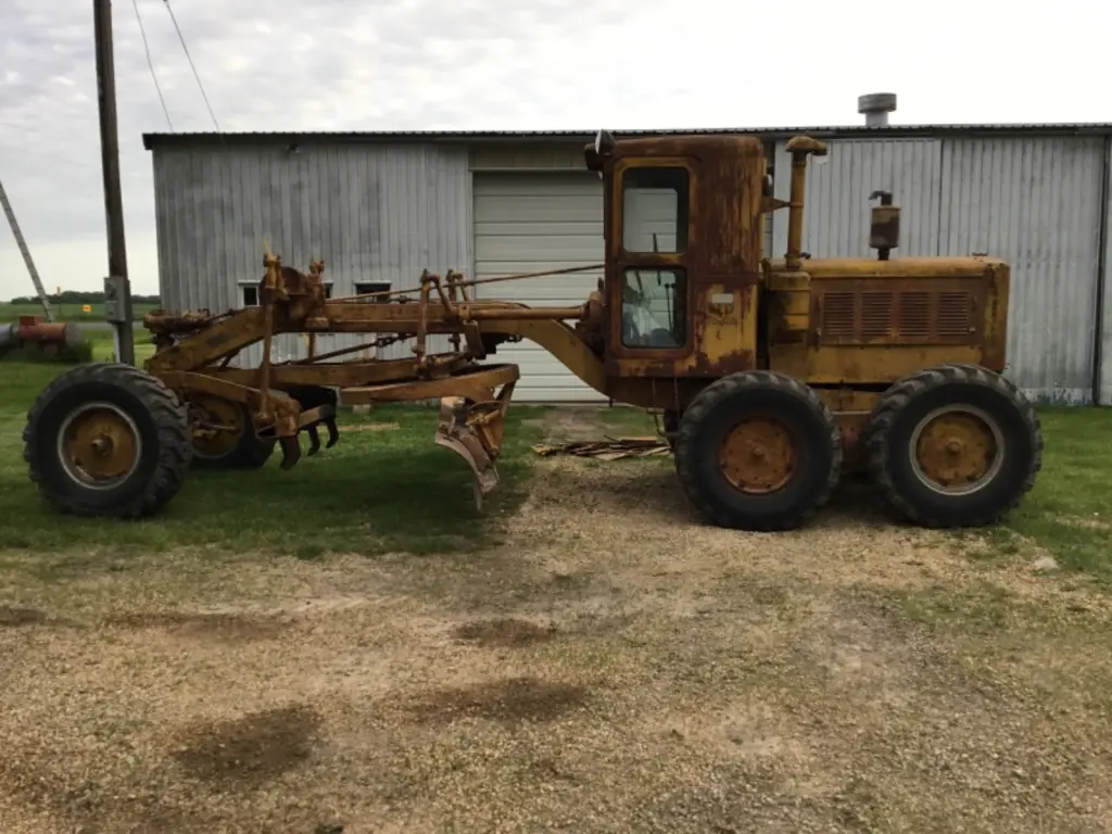

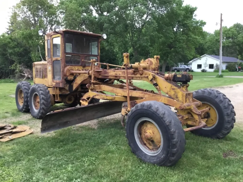

[attachment=75969]52687717-FB0B-4815-BD41-8CD9942A10C8.jpeg[/attachment][attachment=75970]11D34FF1-0B1B-438A-AA8B-32385C15F50F.jpeg[/attachment]

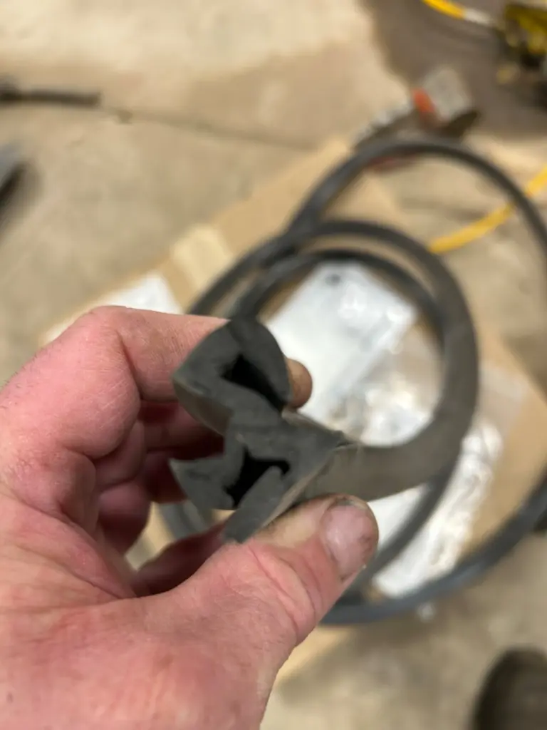

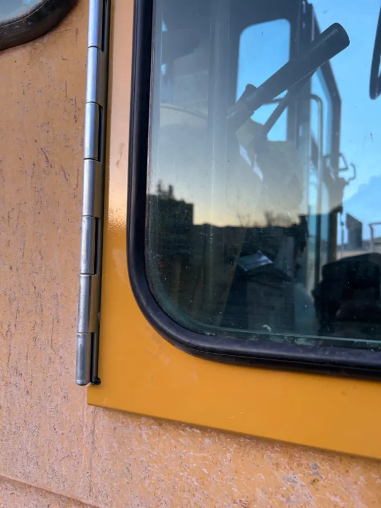

I just did some on the cab of a 14G , s/n 96U
Used part number 5p5768

Your grader looks much nicer than mine. I'd love to have that scarifier even though I don't need it.
