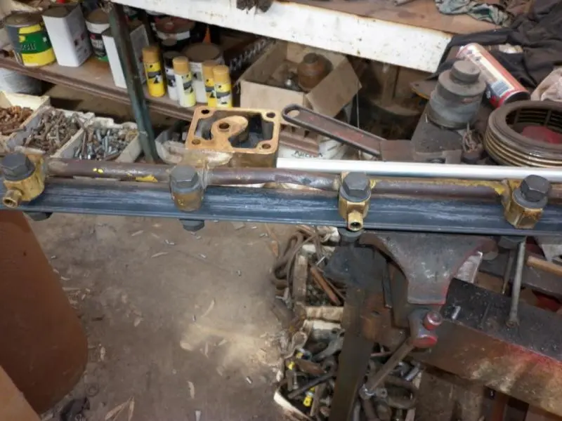

I need to create a new main bearing oil manifold for my D4 2T as the original has been badly damaged and I have a length of new 3/4" pipe ready to go and the old pipe lined up in a simple jig so when I cut it all apart I get it back to original spacing and alignment, just a quick question on what to use to weld it back together, the original material looks like regular solder but I was wondering if it is actually silver solder, or that I should use silver solder or possibly even bronze rods, can someone please tell me which is correct.

D23j beat me to it but double-check the jig if you haven't already - make sure the jig itself lines up with the holes on the block. Sometimes bent pipes can spring once they're loosened from the block and the jig can end up too short
