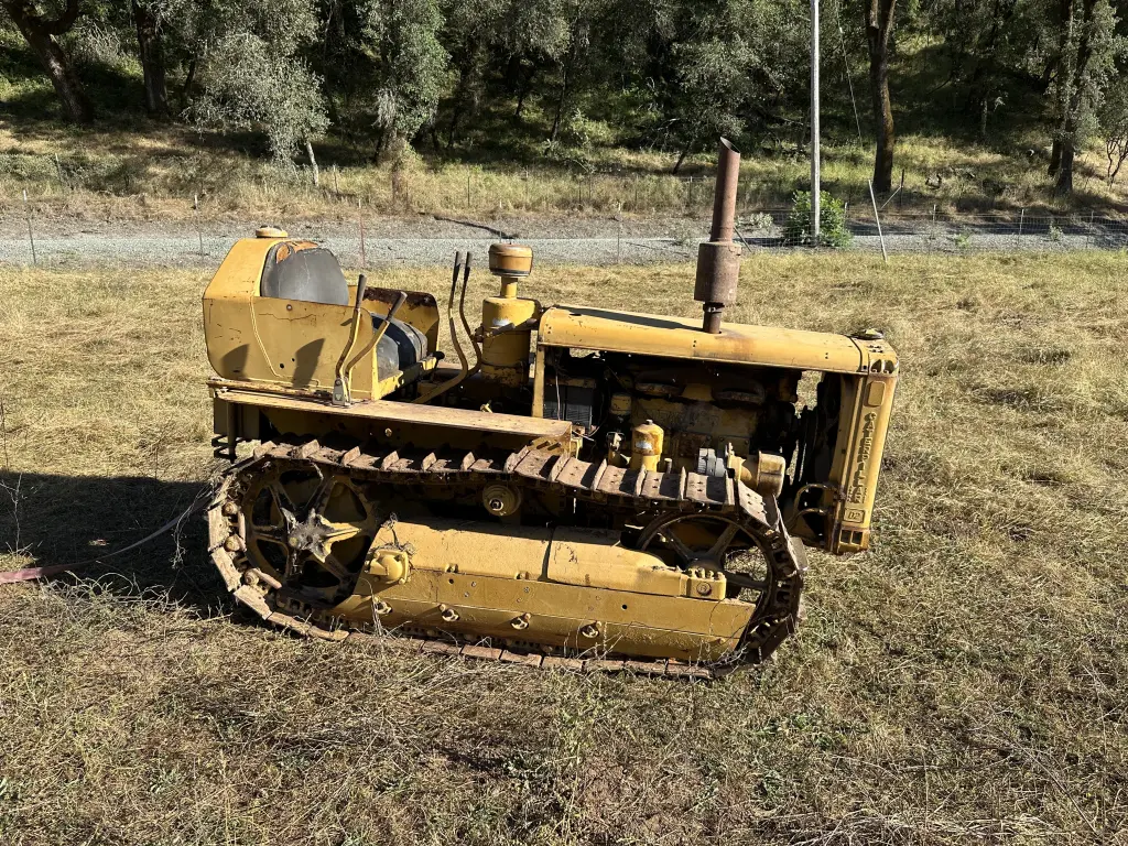

This D2 belongs to a LONG time ACMOC member. He drove it onto our ranch and parked it maybe 6 years ago when he moved out of state. It reportedly ran REALLY good. It has been well covered with protected exhaust since. The oil looks great. I was actually surprised to find it stuck. I think it’s due to condensation, cold wet winters followed by hot California summers, all while under tarp.
The owner is considering selling it, and I offered to check it out and see what she might bring. But he’s of course disappointed about it being stuck and has asked me to consider trying to get her going. And of course I don’t really have time to tear another tractor apart. I think I’m going to get some MM oil in there for a while and see if she’ll come loose. I understand the concerns with hydraulic lock, and won’t let that happen. With the compression release open wouldn’t most excess oil squeeze out of that? I don’t want to debris-score the cylinders but I may have to just hope that would be minimal. Sometimes a guy’s just gotta do what he’s gotta do.
This little Cat has an amazing under-carriage, has direct electric start, and has a rear BeeGee hydraulic pump with 2 valves. It’s really a nice machine.

PW that is a cute little bugger converted to DE from the looks of it. Stuck? I would remove the valve covers and check the valves. I have had stuck lifters before, that just needed some soaking. It might be worth a try before pulling a head.
Looks like your D2 will be getting a stall mate!
