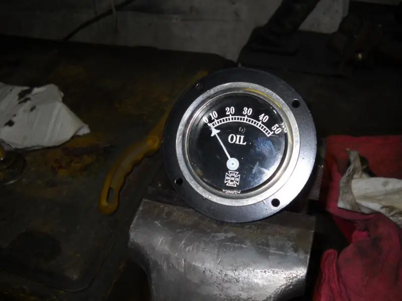

I posted wanting help to have my Sixty oil pressure gauge rebuilt. After calling a few guys and finding a $500 est. to repair.
Wally posted a reply and got me started on doing it myself.

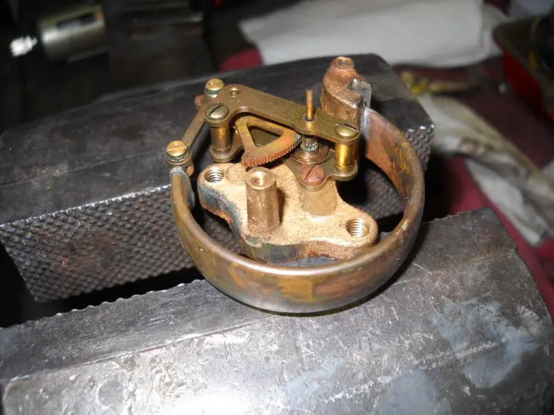

I took apart the worst one I had for practice, then took apart the better one that did work but the face was almost gone.
I took the face to a sign shop and the first guy couldn't get the scale right with 3 tries so to another guy and he did it right the first time.

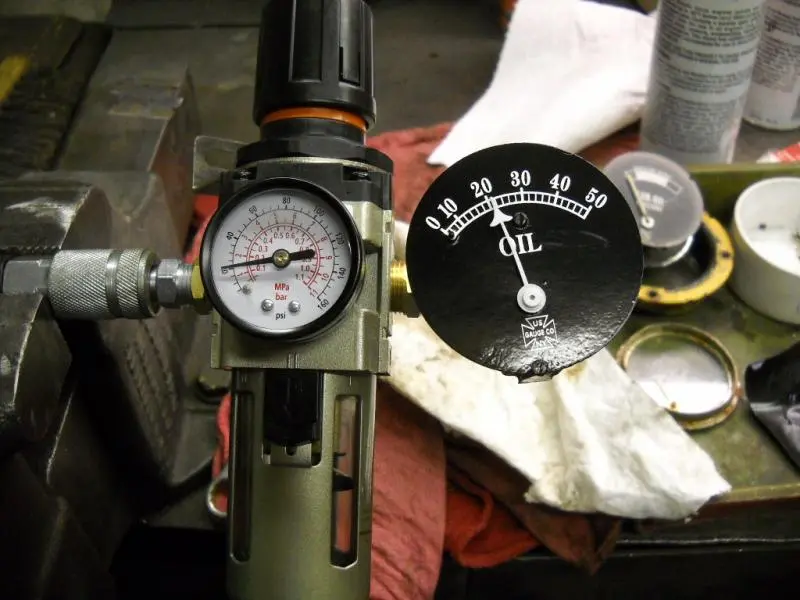

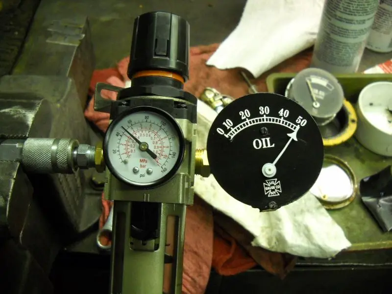

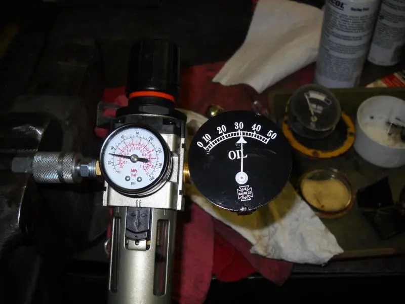

I cleaned a lubed the watch type gears in the gauge, then put the face on. I then applied air with a air regulator to 30 psi and installed the needle on the rebuilt gauge. I checked the calibration from 5 psi to 50 psi and it is very close with in 2 psi.

Thanks for the photo's, you have done a brilliant job there, how do you dismantle the face?

What trick did you use to pull the needle?
Without a "needle puller" it can be tough to pull the sticky ones without damaging the bearings.

The needle pulls kind of hard, pull it before you remove from the outside housing helps. I used a needle nose pliers.
The glass bezel is remove by first running a single edge razor blade around it, then a small puddy knife, then the gasket scraper, buy this time is is almost loose.
I pressed is back on using a large socket in my vise.
