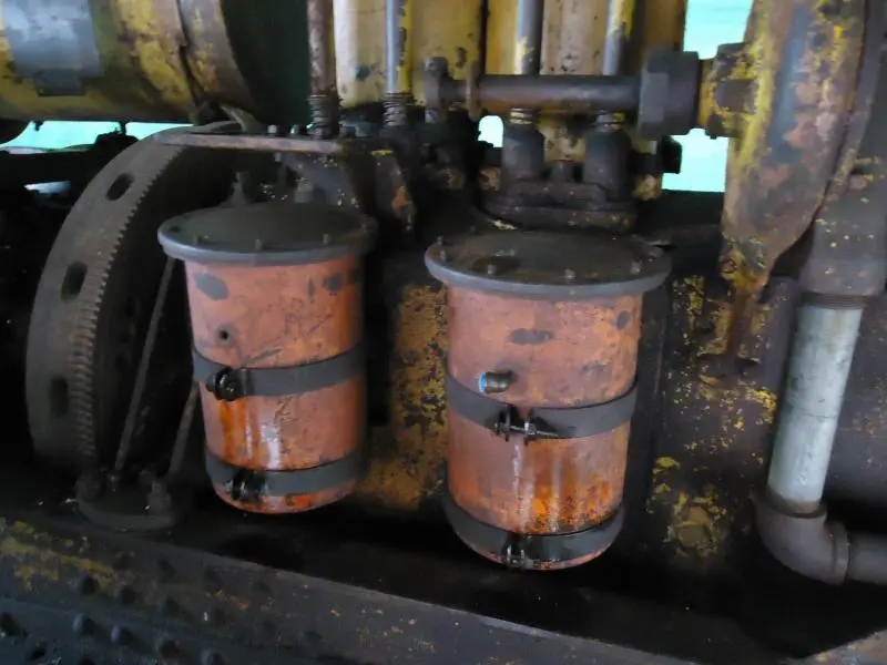

I just start to rebuilt my sixty, and on the right side of the engine are 2 jar's /filter housing ? can anyone tel me te use of these housings ?
they look like filters , but there is nothing in it ??

those are external oil filter cans. I only have one on my sixty and it uses a purolater paper filter.
nice ring gear on the flywheel do you have a starter?

I dont have a starter jet , but i sure gonna find one , it is a lot safer !!!
the previus oner told me that it's a sixty diesel flywheel
