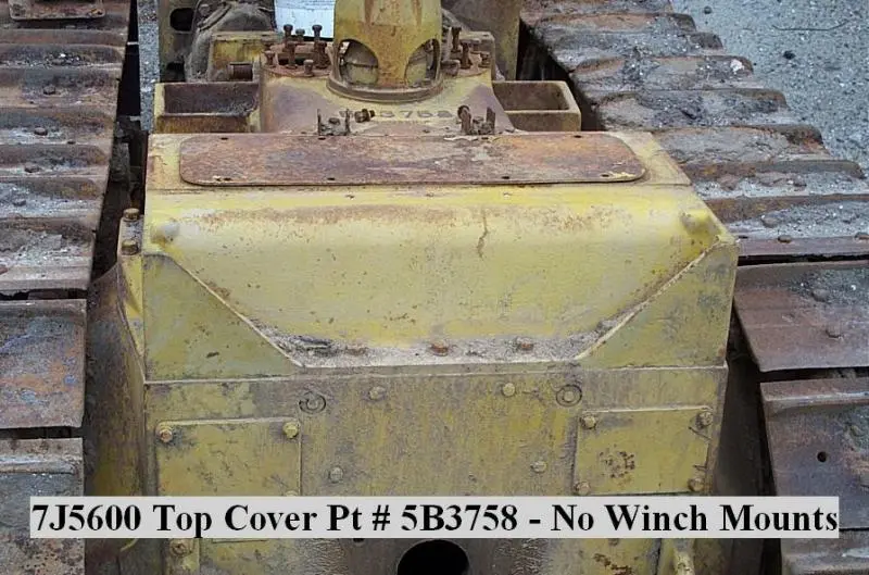

Beware that J model tractors prior to 7J5600 do not have provision for upper winch mounts built in to the cover.
Old Magnet, that probably explains why there are the extra brackets that the winch on my dads old RD4 had. The extra brackets would be needed on my early D4 6U since it is pretty much the same as the 4G and 7J.

Old Magnet, I got confused thinking you were mentioning the U series without the winch mounts built in. My 6U #6070 looks just like the photo you posted of the 7J and I would need the extra brackets if I were to mount the winch. I have no idea of when they changed the rear cover (or if they did?) to accept a winch. Just another little mystery. Grant.

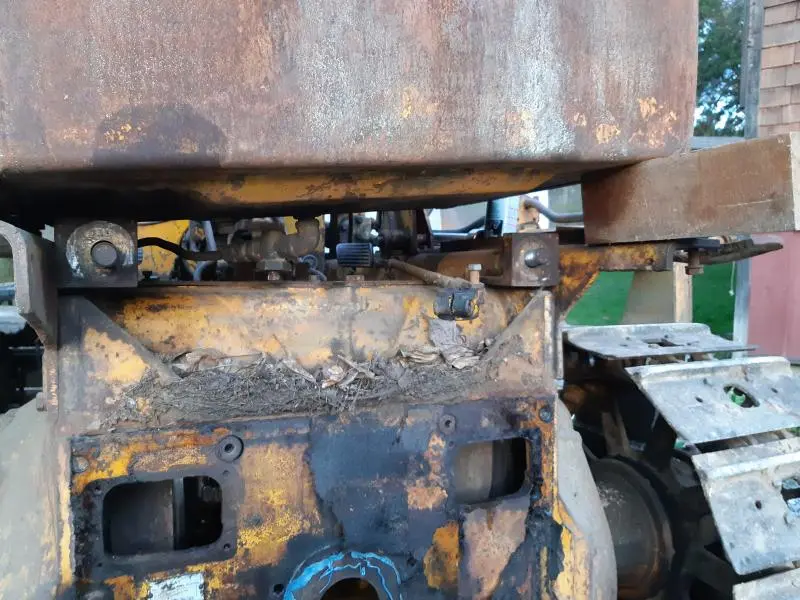

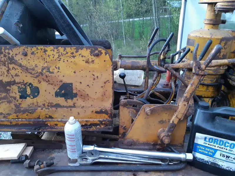

Here are the pics of my tractor. The spacer under the seat is approx 1".
