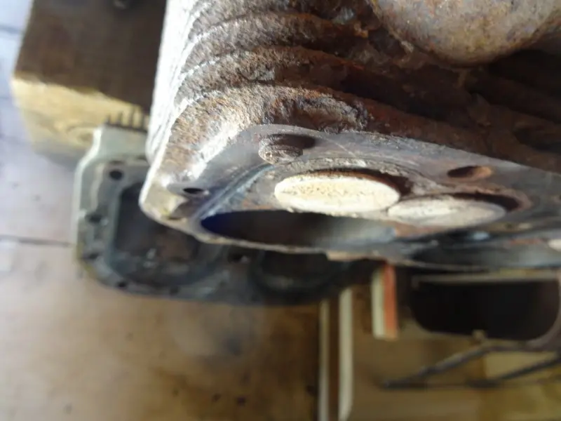

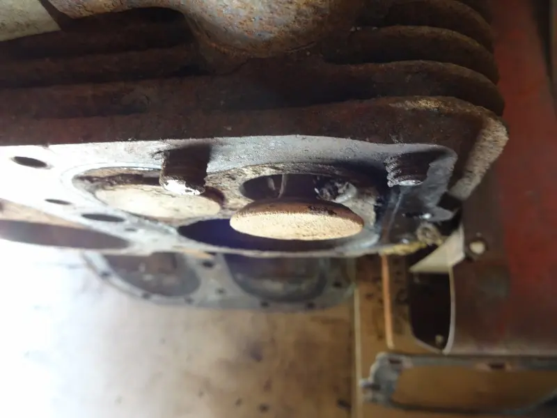

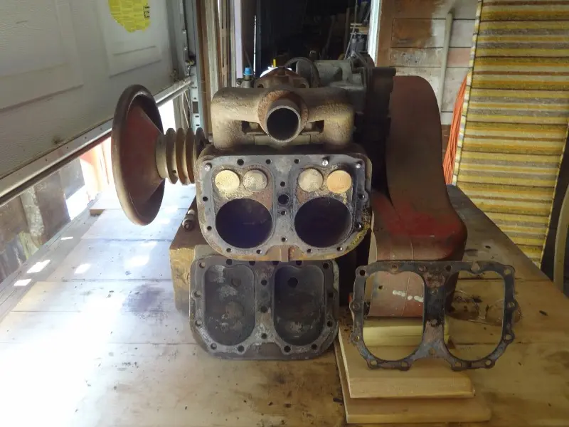

I'm sure this has come up before, any ideas on how to remove
rusted / and broken bolts ( not studs ) out of a cast iron cylinder
block ? after removing the valves / pistons I'm considering heating
the bolts , one at a time to a light orange color then letting cool
for about ten seconds more or less , carefully work it back and forth
with a vice grips to loosen . I don't have a welder so welding a hex
nut isn't a option , and I never have had any luck with drilling /
easy out , that always seems to turn into a disaster...
I realize this is not Cat related , but I thought I'd run it by you guys
anyway
Thanks for looking , Kris
