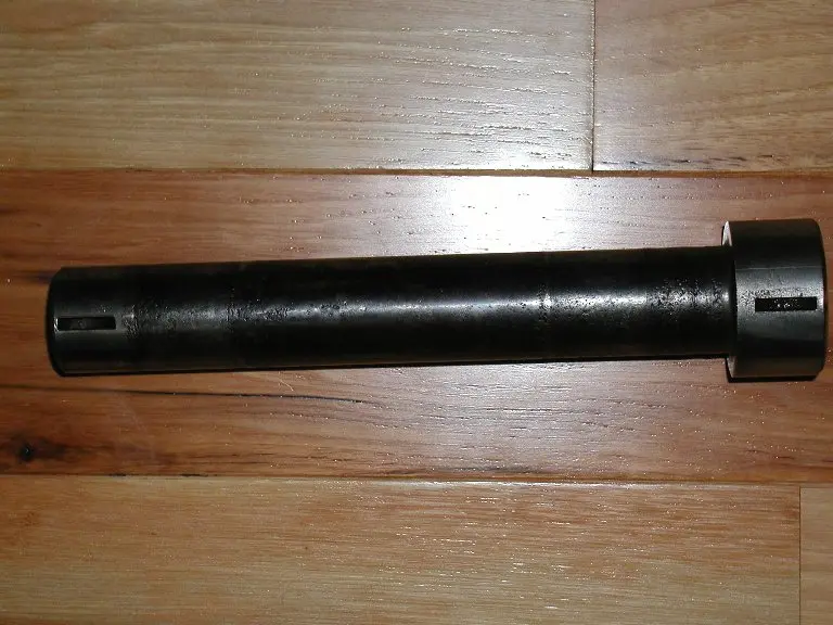

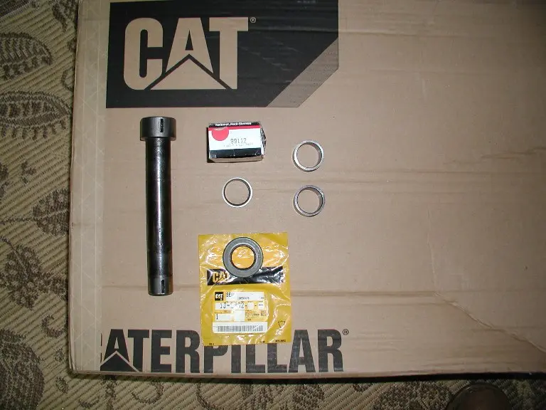

ccjersey is right on about that seal on the control shaft. I had to remove the front cover and pull the shaft to put a speedy sleeve and new seals to keep the water out. Just for the heck of it when I got done I put some grease on top of the seal before I put the control arm and washer back on. I thought it would be better than letting dirt pack back in there and ruin the seal....again.
