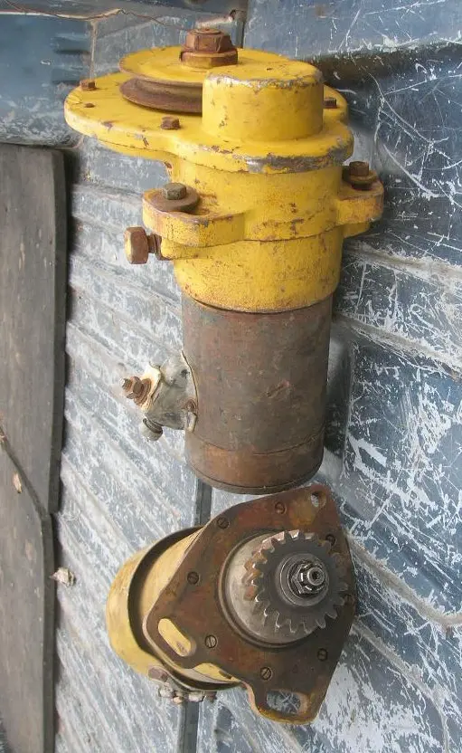

THE 4U and 5U use the same parts for changing to electric
flywell with extra groove
startor
sheild ass.
housing bracket
and I just removed a poney from a d2

looks like this.

looks like this

The housing is bolted on top intake and the sheild ass is the housing with the gear and puley and the breather is instaled in the housing 4f8466 and the trottle and choke rods are connected to the housing.
