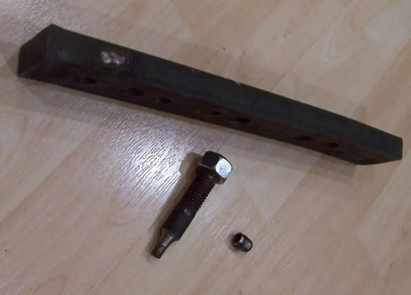

OK, I drilled and threaded the dowel 1/4-28, made a stud with 1/4-28 on one end, 1/2-13 on the other, used a bar across the legs of the bearing cap. The dowel came right out.
If the rod will give me a straight shot in line, I will try to hand drill its dowel and tap it. If I can do that, I think the same method I used for the cap will work for the rod.
The parts book lists the dowels, but I have no idea if they are still available.[attachment=38926]piston rod dowel puller.jpg[/attachment]
