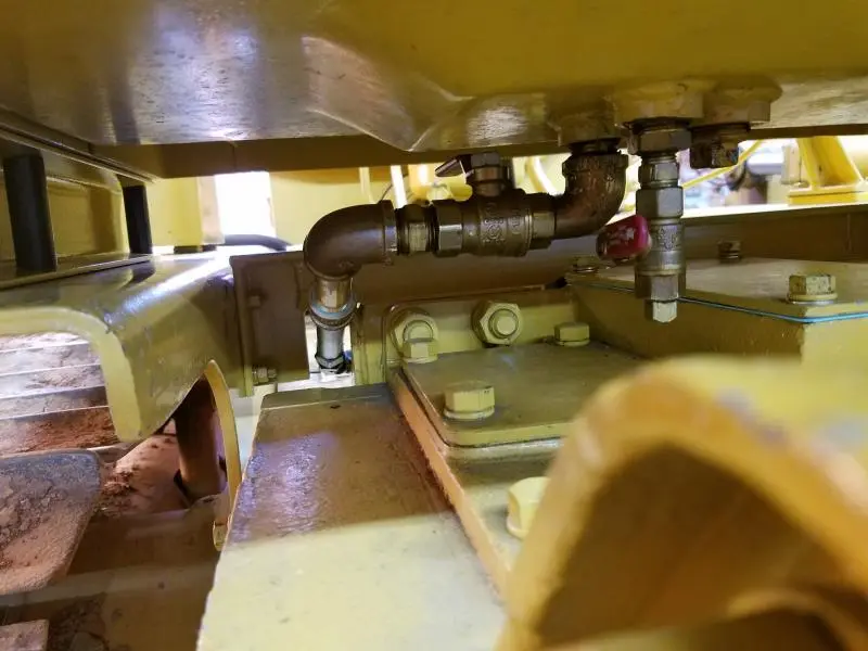

I installed this ball valve on my D2 over 9 years ago..........still works great.
Hope this helps....Bill
