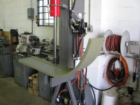

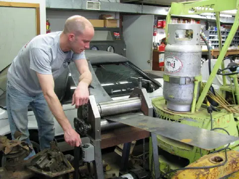

I have been really busy with makeing a riveting press in witch I needed a hyraulic press anyway for my shop. I put it to use the other day riveting my small twenty fenders together. It worked like a champ. I built the press so I could do all types of fenders and the needs of my shop. I also built a roll forming machine witch worked great for rolling the orchard fender. Just wanted to share. Mike

Great stuff! Those are some very handy toys- um, I mean tools.😊 It sure is fun bendin' metal.

Matt it is hard to keep track off what Mike has or what he is working on he has a crawler for every day of the monthπŸ˜„ What do you think of the tools that he made? very smart two brothers.😊
Mike - That is some superb engineering in those two tools you have constructed. I take my hat off to your design and fabrication skills .. 😎
