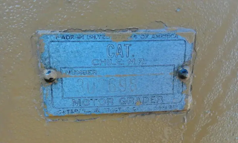

Just bought a Cat motorgrader - old timer. Serial nr 3U2698.
Is there a place where I maybe can get more info [technical specs, etc etc] re this machine?

Pruduced 1947-1957, 3u2698 is an early 1951 model. Without options like scarifier, cab etc 20,500 pounds.
75 Hp D315 4 cylinder engine, dry clutch, 6F/1R transmission 16 mph top speed.

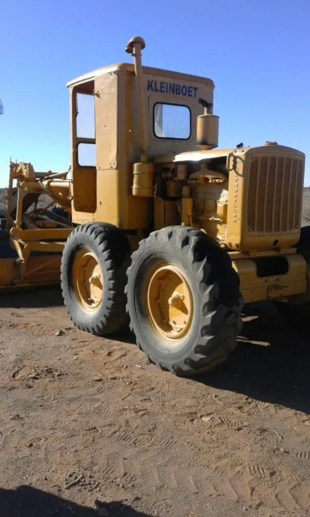

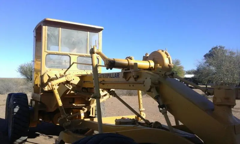

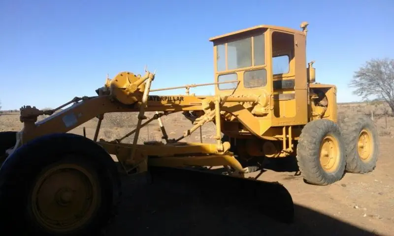

Attaching few pictures

Glad you found the proper manuals. They will pay for themselves many times over. That is a nice looking 112. It looks like it was well cared for. On another note I guess it was a bit of a stretch when I said we probably have members near you. I had to look up Namibia to see where it was. We do have at least one other member in South Africa but I'm not sure where. Is there lots of Cats in your area?
