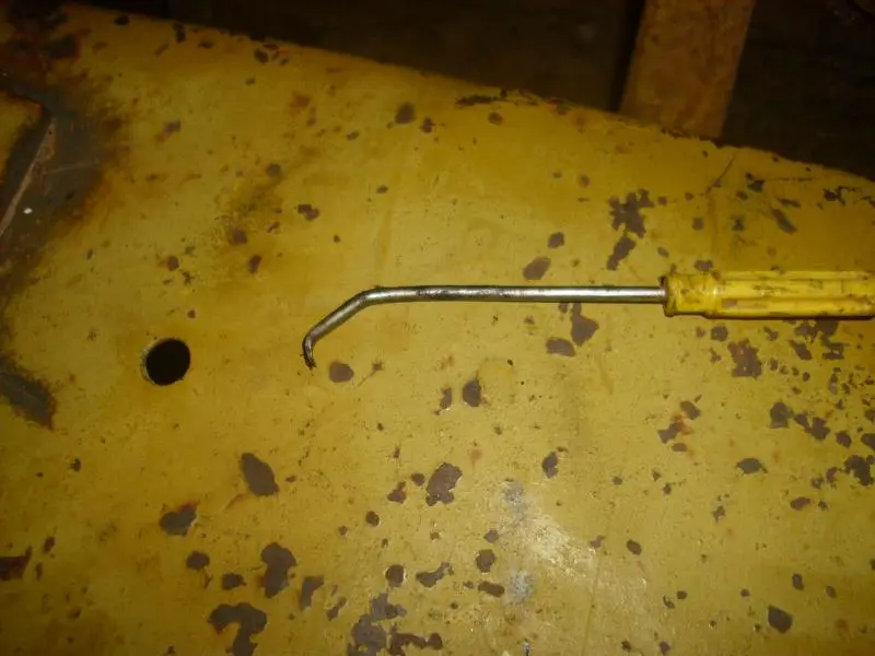

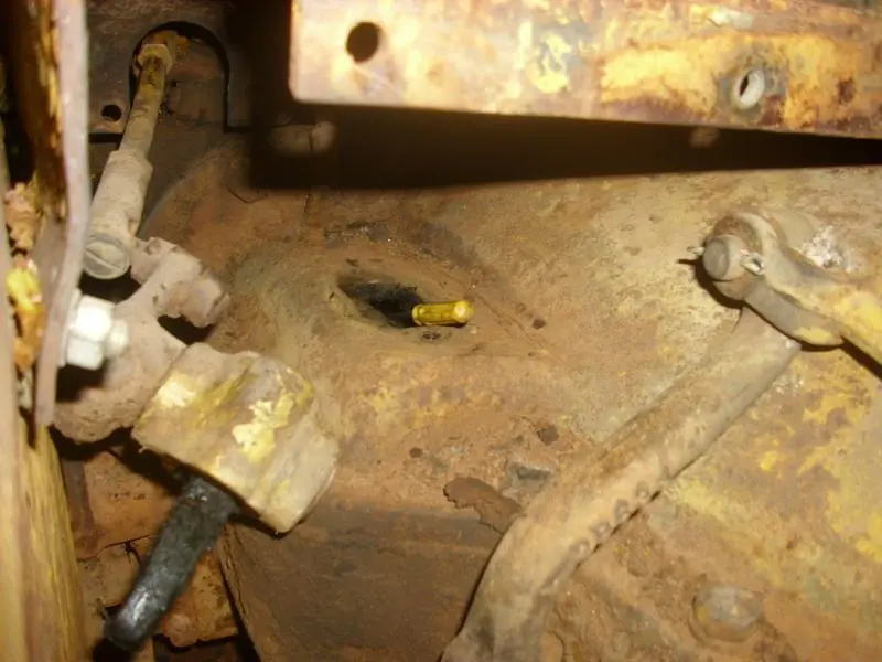

I was able to unlatch the pinion by removing the pinion engaging pivot that is under the tank and sticking a bent several inch long screwdriver under the front of each latch and pulling up. Mark the one that is done first to avoid confusion because the starter crank is perhaps 2:1.
I started the motor and let it run a bit, but still cant get it loose. I ran out of light outside, so I do not know yet if it is the clutch disc or the shaft stuck in the pilot bearing. I will try again this tomorrow.
