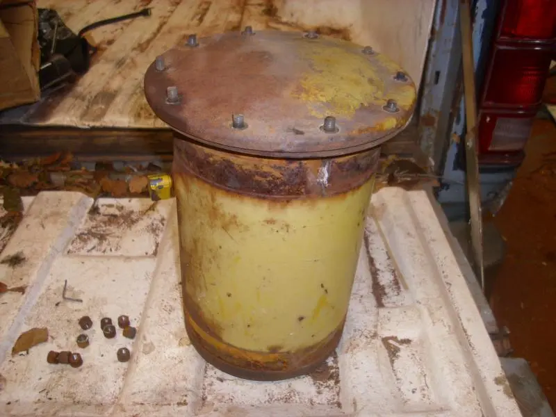

Can anyone tell me an available part number for the oil filter that goes in a canister mounted to the right side of the engine up by the cylinder head on an RD6? My filter is a Hastings 107 and I can not find information or a cross reference for it online. It is about 6" OD and 9 3/4" tall with a spring on top. The canister has a hose feeding it from the line that goes into the rockers and then it has a line coming out that goes into the engine case by the gears behind the fan.

What your describing seems like an aftermarket add on filter of some sort, not the original type. A picture might help to identify it.

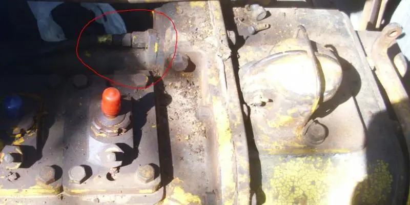

My head is off so I cant show it installed, but I did include a photo showing where the oil line coming out of it goes. I am wondering if there was a factory filter there originally, or if there was just an oil line going from under the head to the location I have circled in the photo.
If there was never a filter there, I will remove it and make a new oil line.

I'm not seeing anything that looks like that in the parts book, including the connection at the governor housing. The rocker arm lube line appears to tie in to the main oil gallery, possibly at the oil filter base.
Need more eyes on this one.

That is an aftermarket oil filter, not sure what brand, but I have seen some on tractors around here. It looks to me like the line you have circled goes in the governor housing. That long tube should contain parts to the governor control. I would opt to use the original filter setup if its on the machine yet. I will do some digging on the filter and see what I can find.

Looks like someone has modified one of the governor control tube mounting bolts to connect a line. I don't see the logic for any of it.
