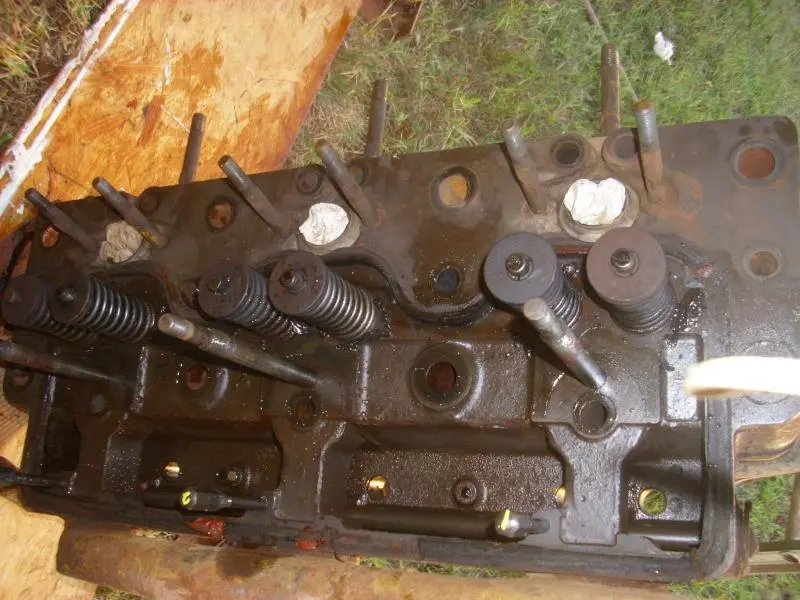

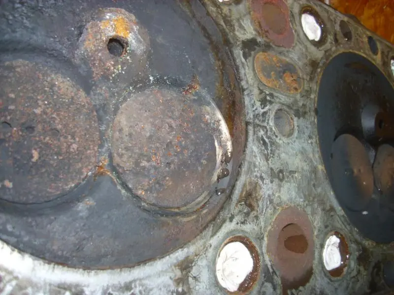

Good evening,
I finally removed the head and it is leaking around the outside of the valve seat repair I had done 20 years ago. I plugged the holes and filled the head with water to find it. The repair was done by flame spray. I doubt it is repairable.
Does anyone know who would have a good head for sale that would ship to Oklahoma at my expense of course? I sure would appreciate it.
Please let me know.
Thanks,
Scooter
Fri, Sep 23, 2016 7:31 AM

Good evening,
Please let me know.
Thanks,
Scooter
My name is Bill Walter, member of chapter One, Kansas City area. I rebuilt the clubs RD 6 several years ago. I also rebuild Injectors and can check the pumps for preformance. I rebuild fuel transfer pumps and recondition gauges. Give me a call or e-mail me; 1 816 805 [email protected][/email]
The cylinder head would be the same as any old D8 of the same vintage. Bill Walter
