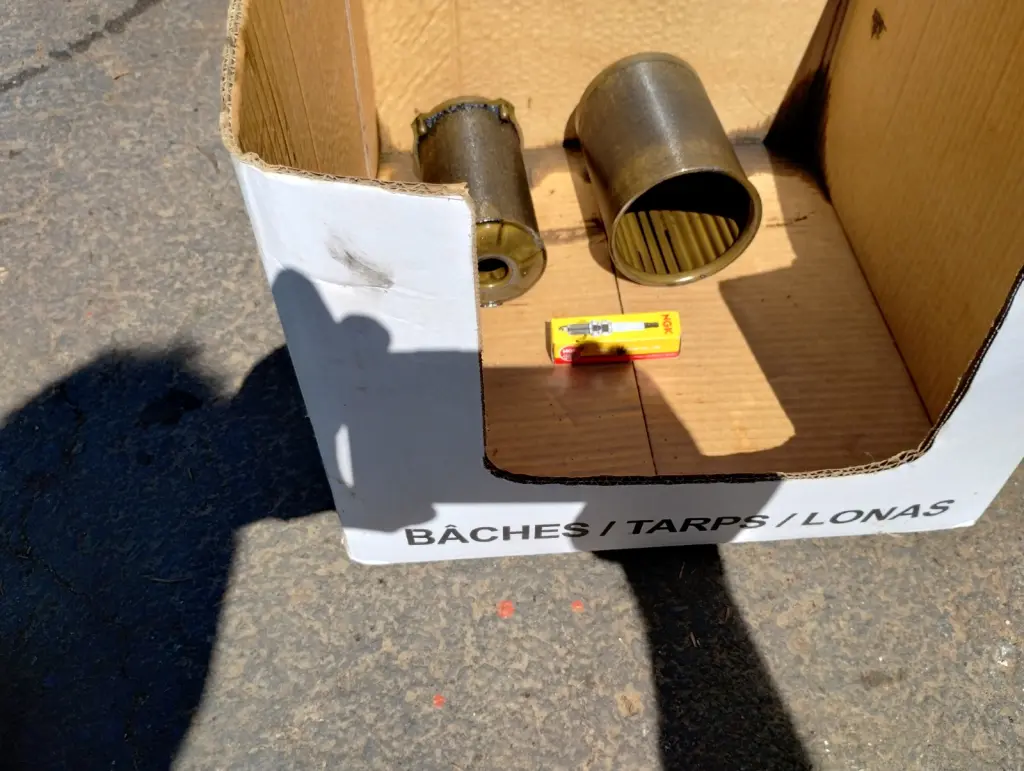

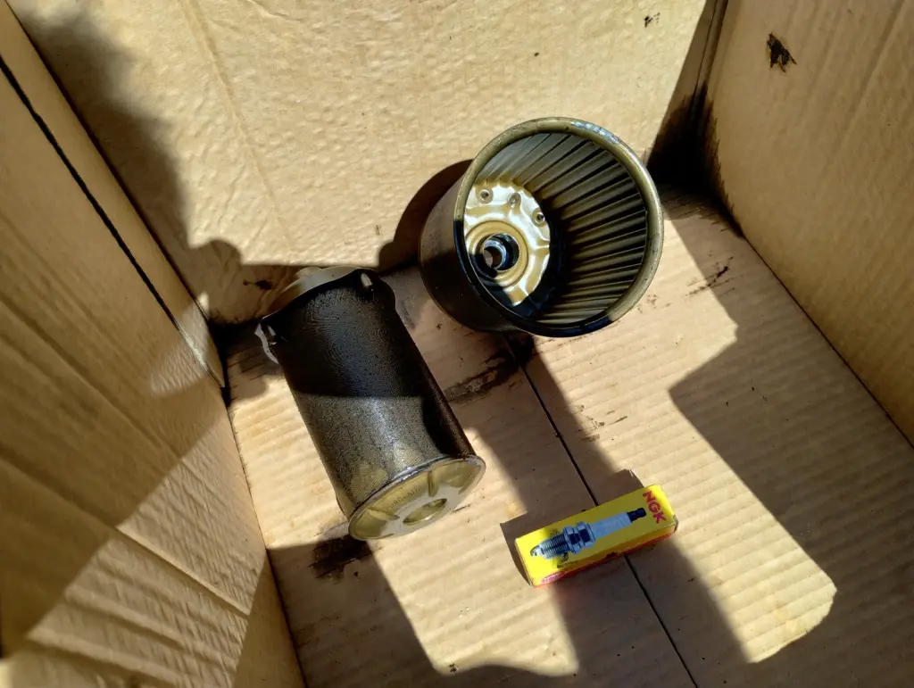

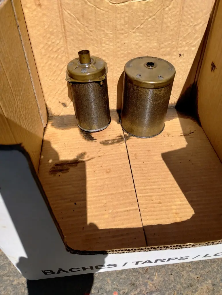

I drained the oil, and removed the oil filter and air filter. The oil filter is like nothing I've seen before. It has inner and outer screens in the bottom portions. There is a little dirt on them. What's the best way to clean them? and then what about the upper portion? is there more to be dismantled and cleaned? How is this filter work? The upper part is heavy, and one small line entering the top, the lower base has 2 large lines running to it. I'm wondering if I there is another drain besides the drain on the pan. I have a lot of dirt to remove.

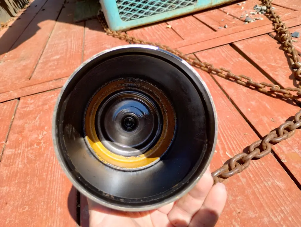

The oil bath air cleaner had non-detergent oil in it. The dirt (a lot in there) settled out in the bottom. Is non-detergent oil the preferred oil in a oil bath cleaner? Detergent oil would have held the dirt more in suspension where only the heaviest crud would have been on the bottom. Which is preferred?

The reason I asked about air bath oil in a air cleaner is the filter coils  where the oil is drawn up into was really clean as was the non detergent oil in the pan. That oil smelled very old and was a gray blue/green color but didn't look dirty, but the cup was full of insects under the oil and the almost half inch of dirt on the bottom was solid. I thought that since the oil was able to stay clean because the dirt settled out maybe non-detergent was possibly better. I have always used leftover new oil in my jeep oil bath like you described.   [attachment=77286]IMG_20240805_132359803_HDR.jpg[/attachment][attachment=77287]IMG_20240805_132552724_HDR.jpg[/attachment][attachment=77288]IMG_20240805_132627152_HDR.jpg[/attachment][attachment=77289]IMG_20240805_132702269_HDR.jpg[/attachment][attachment=77290]IMG_20240805_132722814_HDR.jpg[/attachment] [attachment=77286]IMG_20240805_132359803_HDR.jpg[/attachment][attachment=77287]IMG_20240805_132552724_HDR.jpg[/attachment][attachment=77288]IMG_20240805_132627152_HDR.jpg[/attachment][attachment=77289]IMG_20240805_132702269_HDR.jpg[/attachment][attachment=77290]IMG_20240805_132722814_HDR.jpg[/attachment]

I'm not sure why double pictures got in there.
I put the spark plug box in there just to give some reference.

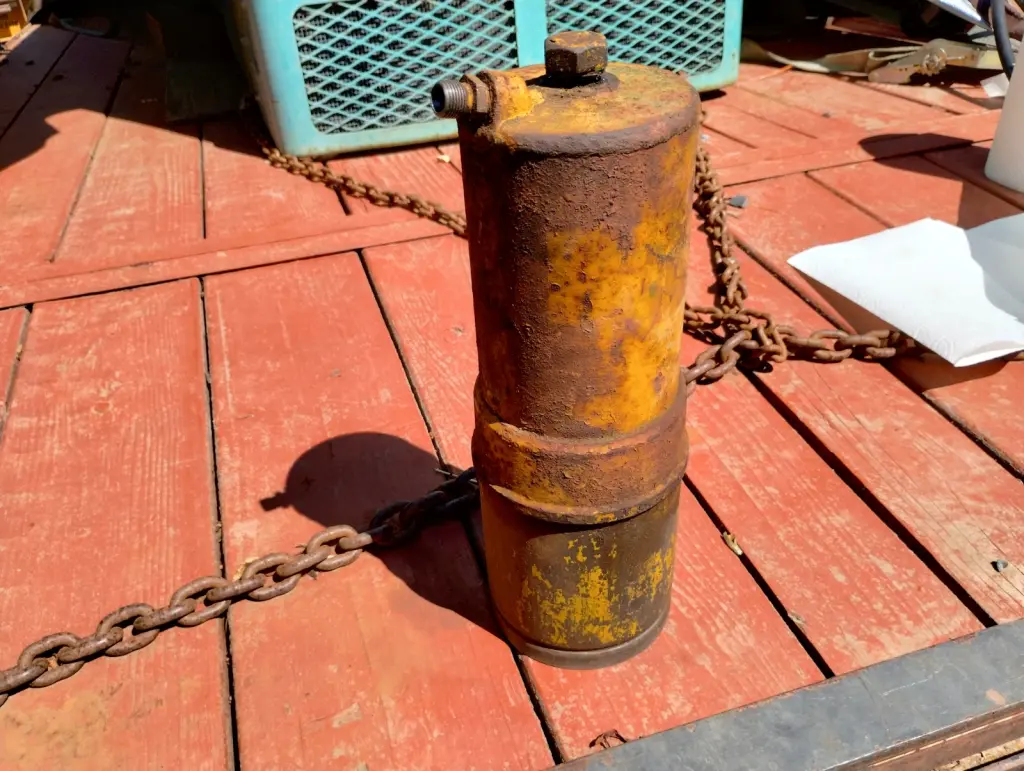

The top portion of the canister shown is surprisingly heavy, and wondered if it's supposed to be removed for cleaning

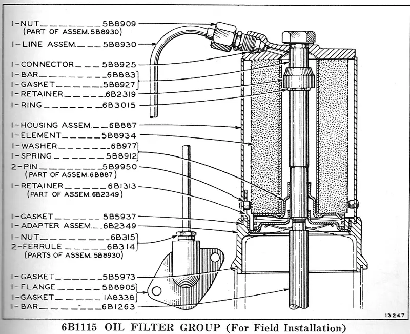

That filter unit has the optional secondary filter used with the original bypass filter.
 [attachment=77291]Supplementary Oil Filter #1.jpg[/attachment]
Thanks for the diagram. It looks like that element should be cleaned in there. By the looks of my filter, I don't think it has been separated in a very long time. By removing the bolt on top will it separate? I'm concerned if I do get it apart that I might not be able to keep it from leaking, especially if finding a new gasket is a problem. Thanks

Mine looks just like the one in the video except the base is still on the tractor. That long tube he used the made socket on stayed on the base on mine. It looks like mine should just unscrew, but it won't come by hand like his did.

The 5B8934 element is the disposable type and should be changed with each oil change. The element is still available along with alternative manufacturers.
What is the s/n of your tractor?

as for the oil bath air cleaner it doesnt really matter what oil you use. just use the same as the engine and you cant go wrong.
wash it in kerosene. soak it and then slosh it up and down repeat a few times before rinsing it with fresh kero. let it drain well and reassemble only fill to the line on the bowl.
