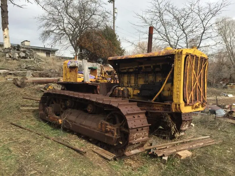

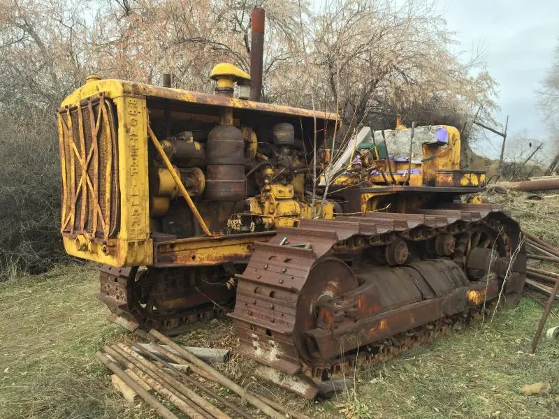

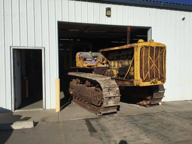

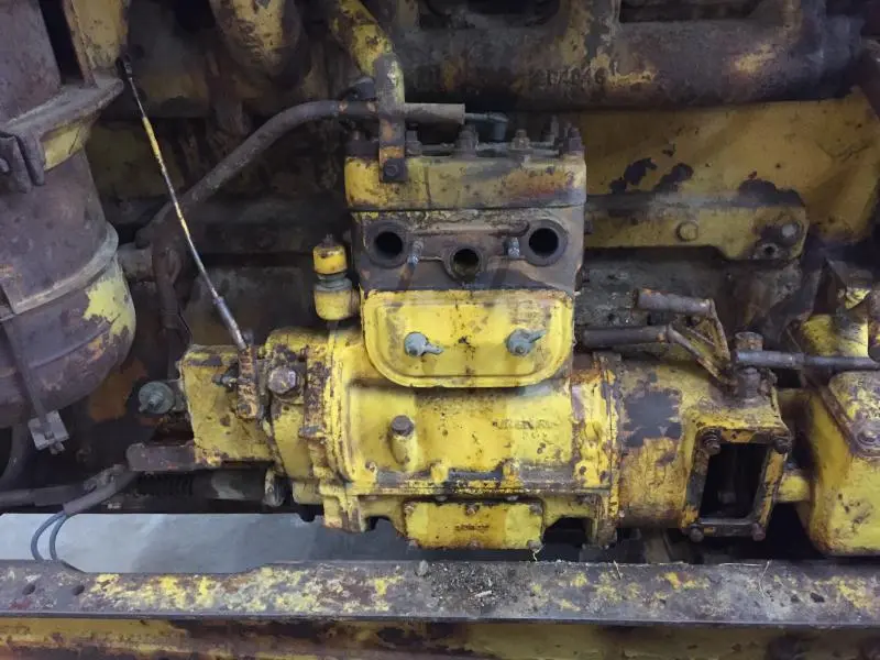

So I had a friend that told me about a old RD-8 that needed a new home or would be junked, so needless to say I made plans to go look at it the next day .The tractor had ben purchased in 1964 and siting idle sense then behind a apartment complex in downtown salt lake city . I made a deal with the owners son on the cat and started planing for the rescue , it was on the side of a wetland behind a house in a residential area with very limited access . The next day my dad and I loaded the transport with a 951c and headed out to retrieve our new find , it turned out to be one of the toughest retrievals yet as the tracks were froze on the RD-8 and the hill up to the road was slick and narrow . We finaly got it to the shop yesterday and into the shop , I am glad to say both engines are free . The previous owner had removed the mag and pony motor gas tank , it needs lots of work to get it going but I am happy with it so far . let me know what you think !

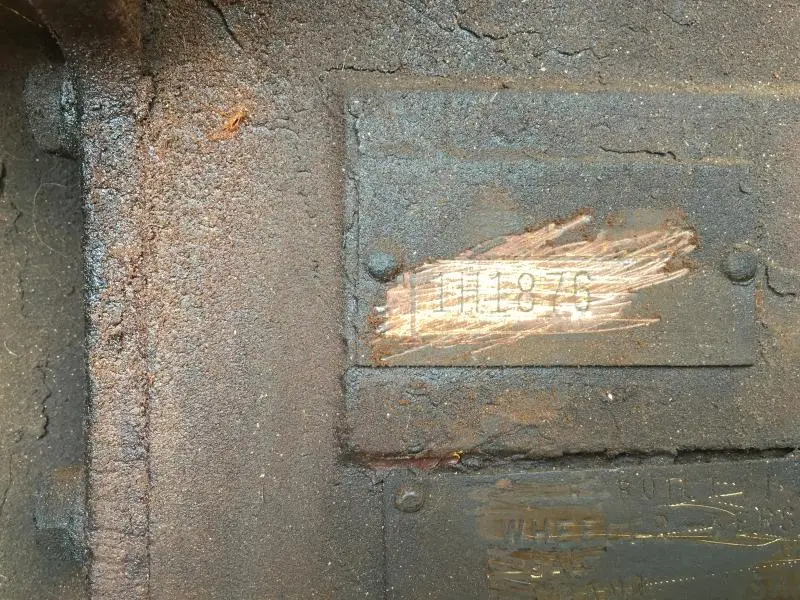

Looks Good! That's around the last RD-8 serial number when changeover to the D8. you have a 1937 year. I have some parts from my 75 rebuild and a RD-8 parts tractor also if you need anything. Gary

Nice save! What's the tag below the serial tag? Any ideas why they never used it?

bruce , the lower tag is a rebuild tag from our local cat dealer wheeler-kershaw caterpillar now its just wheeler as there was a buyout in the late 50s , it says crank and rods on the main have ben ground and the pony motor it std . Also it has a date of 1953 , the hrs. meeter shows around 4 thousand hrs. but I don't know if it works but I hope it is correct . rome/kg , I sent you a pm . I removed the pony carb and manifold yesterday to clean out all the mud wasps nests in the intake , ill be needing the short pipe between the pony manifold and the diesel intake if a good one exists . thanks for all the replies .
