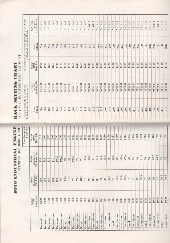

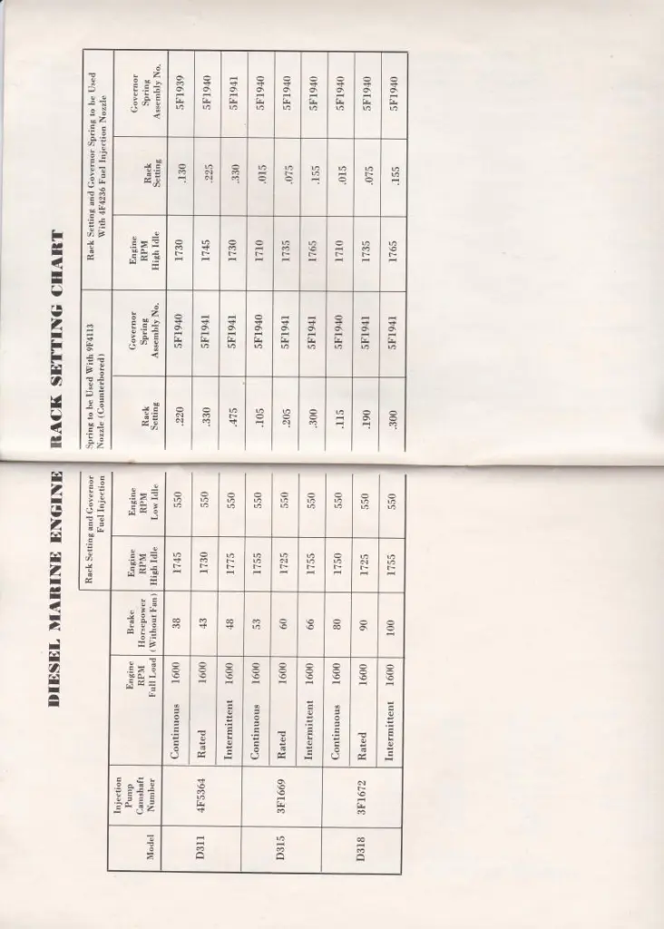

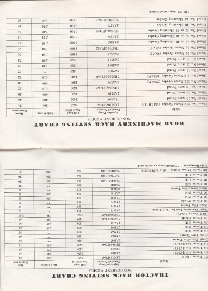

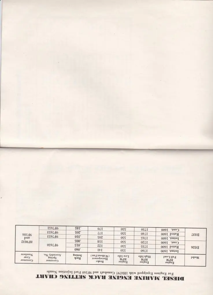

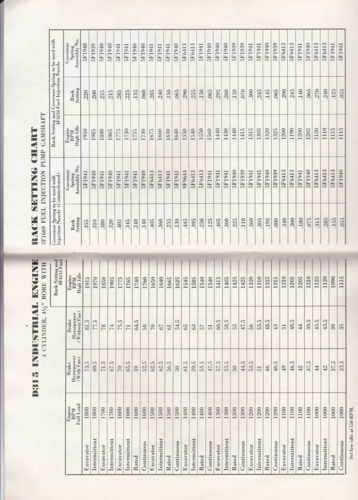

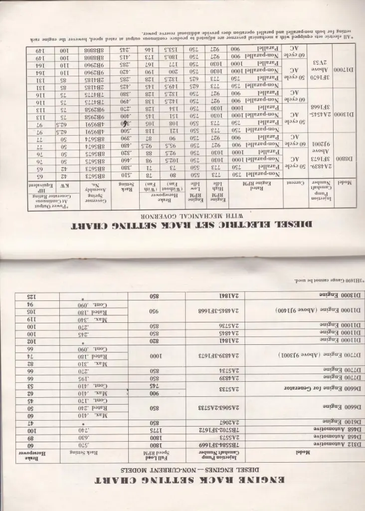

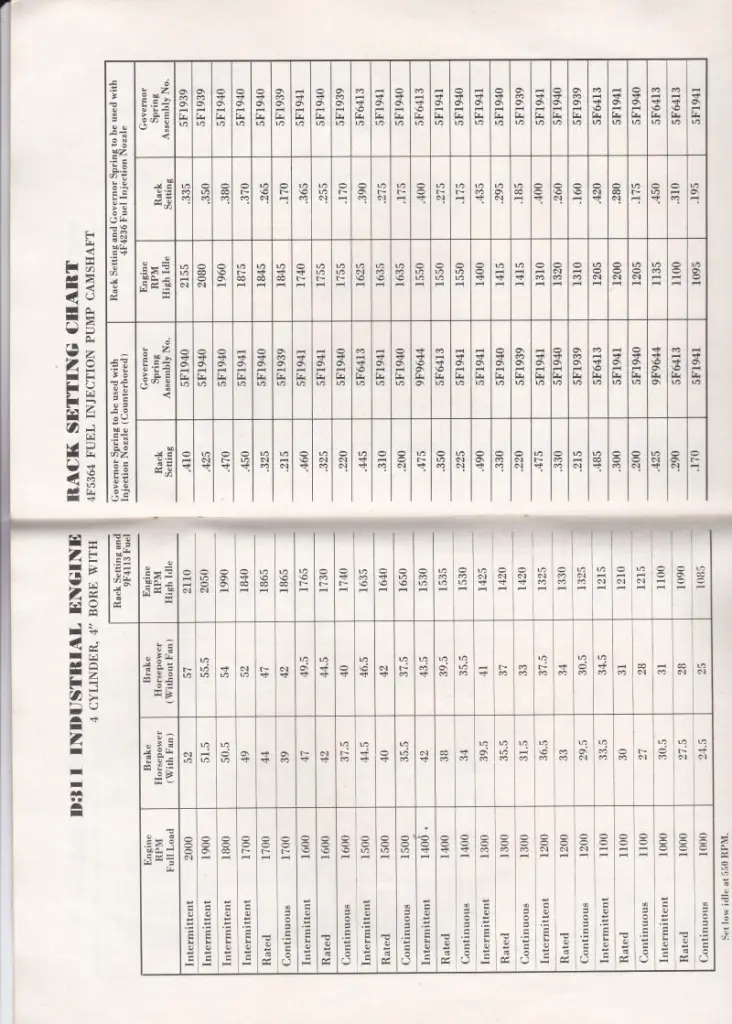

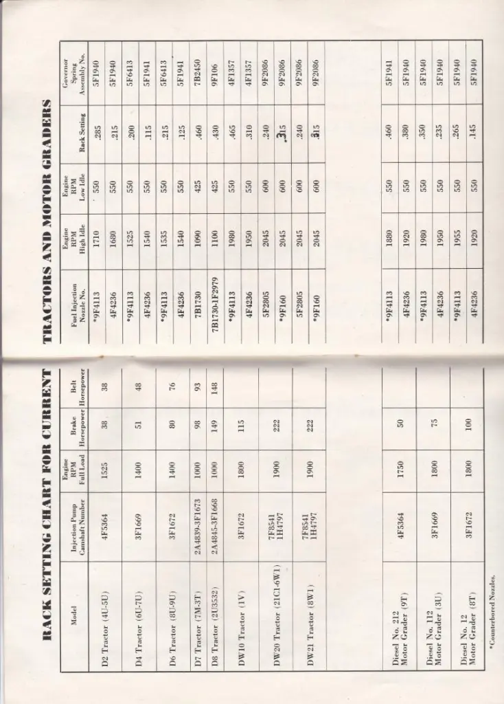

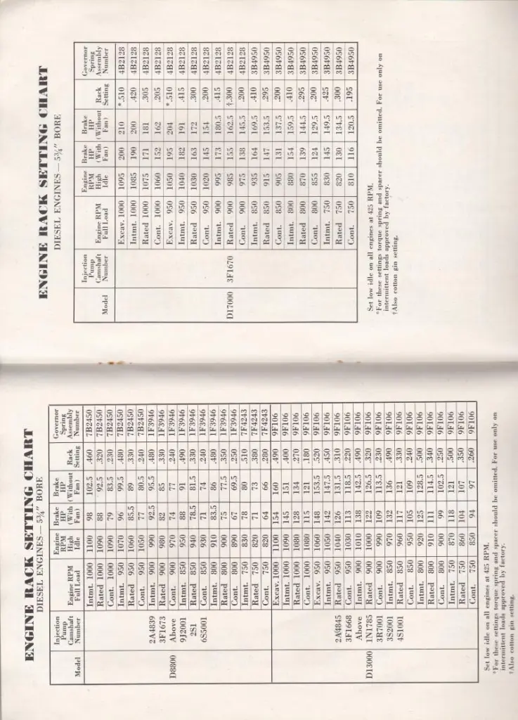

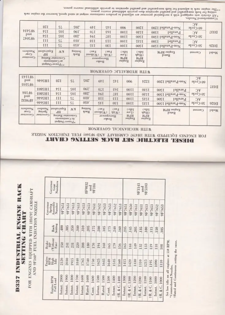

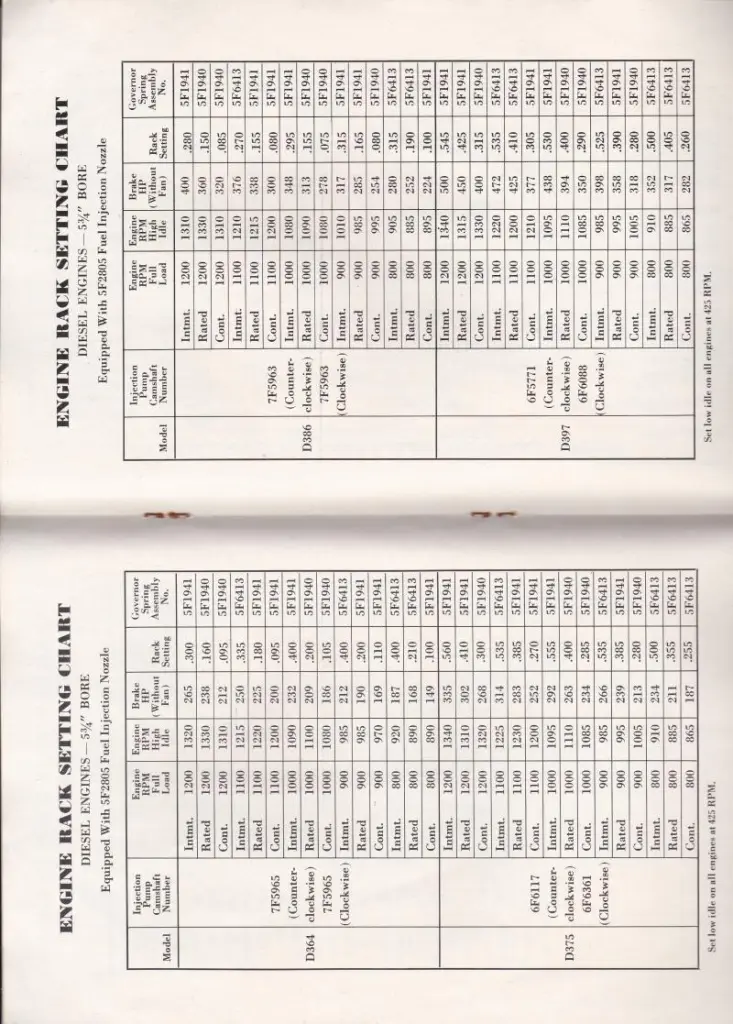

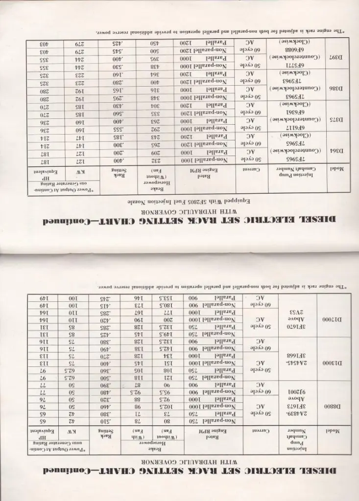

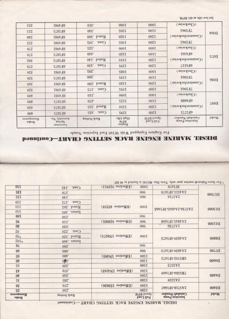

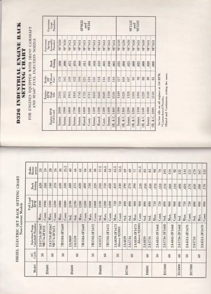

Here's a little info that I think we all could find useful from time to time, using a 3H1690 rack setting tool. Sorry the files are not all "in order."
Thanks,
Wyatt

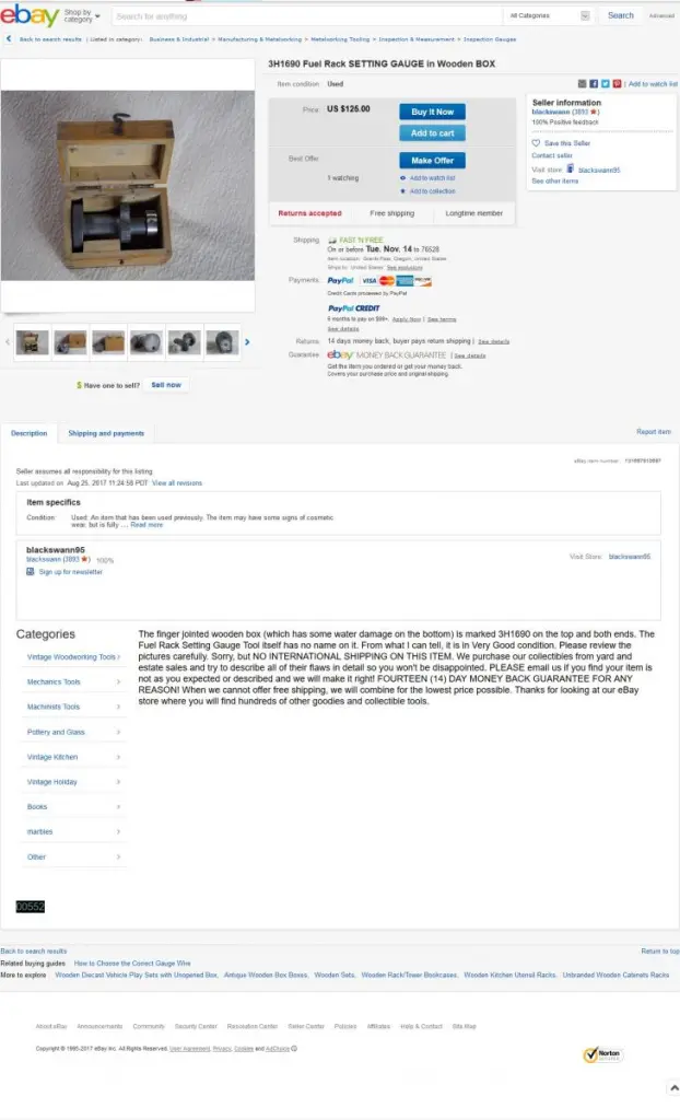

I was looking for a different Cat tool on Ebay the other day and ran across the 3H1690 Rack Setting Tool to go along with this info if anybody is interested in it.
https://www.ebay.com/itm/3H1690-Fuel-Rack-SETTING-GAUGE-in-Wooden-BOX/131697910697?hash=item1ea9cea3a9:g:YOgAAOSwZG9WkupR
[attachment=45492]3H-1690 Rack Setting Tool.jpg[/attachment]
