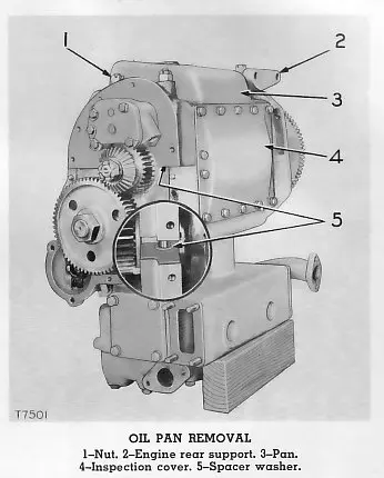

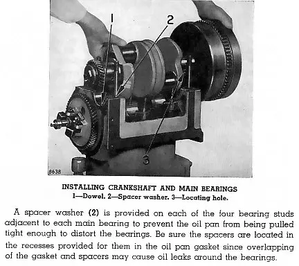

Hi Jan,
when you remove the pony sump check for and keep aside and wired together with a tag to identify them for refitting at the time of assembly the 4 - 2B4219 spacer washers on the main studs that prevent crushing of the main bearings onto the pony crank main bearing journals.
Have in the past had to fit several of these after clients rebuilt their own ponies and neglected to refit the spacers.
The clients mechanics had luckily found their ponies tight to turn and embarrassingly had the Dealer check further.
As I do not have the relevant engine SRB, the scans below of different model ponies should show what I speak of.
Fri, Mar 3, 2017 7:20 AM
Bruce P
Posts: 2,303
Reply to edb:
Hi Jan,

Hi Jan,

Eddie,
I did read about the washers in the book just before separating the two pieces but it was a bit of a fight to get them apart so the washers eluded me in the process. They are probably laying on the garage floor where it all happened and I will be sure to put them back when the time comes. Thanks for the heads-up.

It has been awhile since this project started and now an update. I ended up having the cylinders line-bored to 0.040 over in order to get smooth cylinder walls again. When I picked up the block today from the re-builders, only 3 spacers showed up with the studs. I have found many spacers showing up in Machinery Trader Parts so no problem getting the replacement. The crankshaft continues in the chrome vat still building up thickness so that is the only thing still not here. I have gathered gaskets, seals, pistons, rings and other needed items mostly from two sources listed on Machinery Trader- F P Smith and CIS in Tn.
