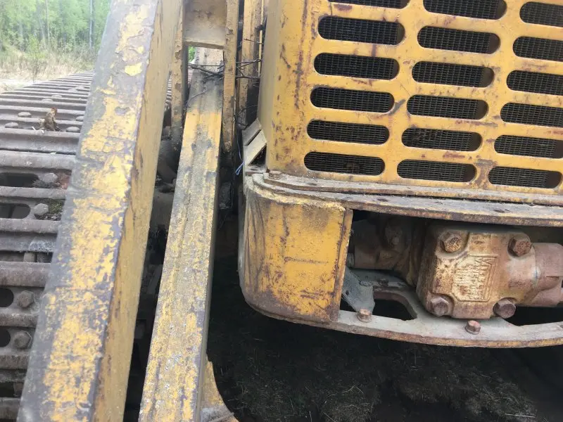

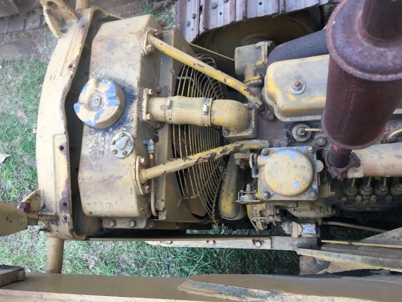

I've got a 12A-08263 Traxcavator track loader with a D315 with a supposedly seized engine. I want to turn the engine over by hand to see if it actually is seized and/or where the slop is. The 12A has a front Hyd. pump and limited access to parts I normally use to rotate engines. I have considered using the pony by engaging the clutch and turn over the pony by hand. Which leads me to the second question ... how do you unlatch the pinion clutch without the diesel engine kicking it out? Pony in sad shape the oil has been gas washed by bad starting practices. Pony may start but it is not long for this world.
Suggestions anyone??
Thanks for looking.
[attachment=59295]D315 Traxcavator.jpg[/attachment]
[attachment=59296]front pump.jpg[/attachment]
Thu, Jun 18, 2020 5:13 AM
You can open up a small cover on the clutch housing over the pinion and bump one of the latches to disengage the pinion from the flywheel ring gear.

Yes sorry. I have one a 12A-3563 The spring Tensioner was way out of adjustment Allowing the clutches to slip and the latches were locked and I could not figure out how to unlatch Without loosing a finger. But it needed to be removed anyway. After removing I found the latch work well, the clutches may need replaced but everything else looks ok till I go a little deeper into the clutch.
So the little two bolted plate pulls off and it MIGHT be possible to trip the latches.
I looked in the wet clutch access on 3563 And I could not see enough to trip the latches and keep my all of my fingers.
Thank you so much.
Any suggestions on turning it over by hand πŸ–. Another option will be pull the yoke on the hyd. pumpAnd use the front of the crank.

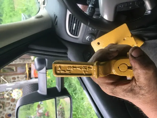

Dag-nab-it my Decompression lever is MIA at the moment. Have to find which Way To turn on the decomposition shaft. Poooo buckets.
[attachment=59297]79E7C2A6-748D-46D6-9191-7E4602A89BD2.jpeg[/attachment]
Righty runny and lefty starty
