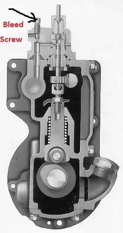

If I pull the bleed screw can I get the atf/acetone down to the plunger??
Thu, Jul 16, 2026 10:25 PM
Busso20
Posts: 370
Thank you received: 29
I would suggest so, as air/fuel is released when bleeding, as per Edb picture you can see the journal to the plunger chamber, hopefully your super lube will reach the plunger
Thu, Jul 16, 2026 10:47 PM
bobby h
Send a private message to bobby h
Posts: 9
I was not able to get anything in the bleeder screw orifice so I just tapped on the lifter with my 1.5-2 oz hammer very gently and used snake oil # 3 rust bomb and after setting several hours I got it to move slightly and kept after it. The plunger started moving and the rack moved , I bleed the injector line and she LIVES again.
