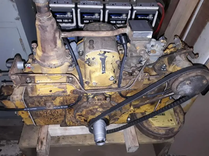

Hi All,
Here is a photo of a pilot motor that i have done up for the 7U when the engine is rebuilt. As you can see it shows the linkages for the throttle, choke and governer (yes i know its not connected). On left you can see the buttons that hold the throttle in postion and on the right you can see the adjusting screw/nut for the governer.
Regards
